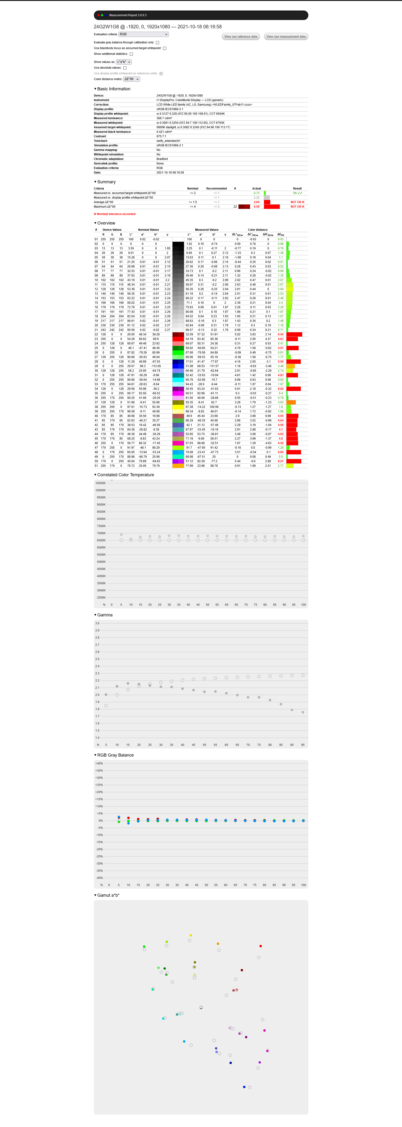

Colors; kinda eh, out of the box its way too blue, gamma is messed up, no setting saves the gamma - you NEED to calibrate it
Calibration does NOT fix all the colors.

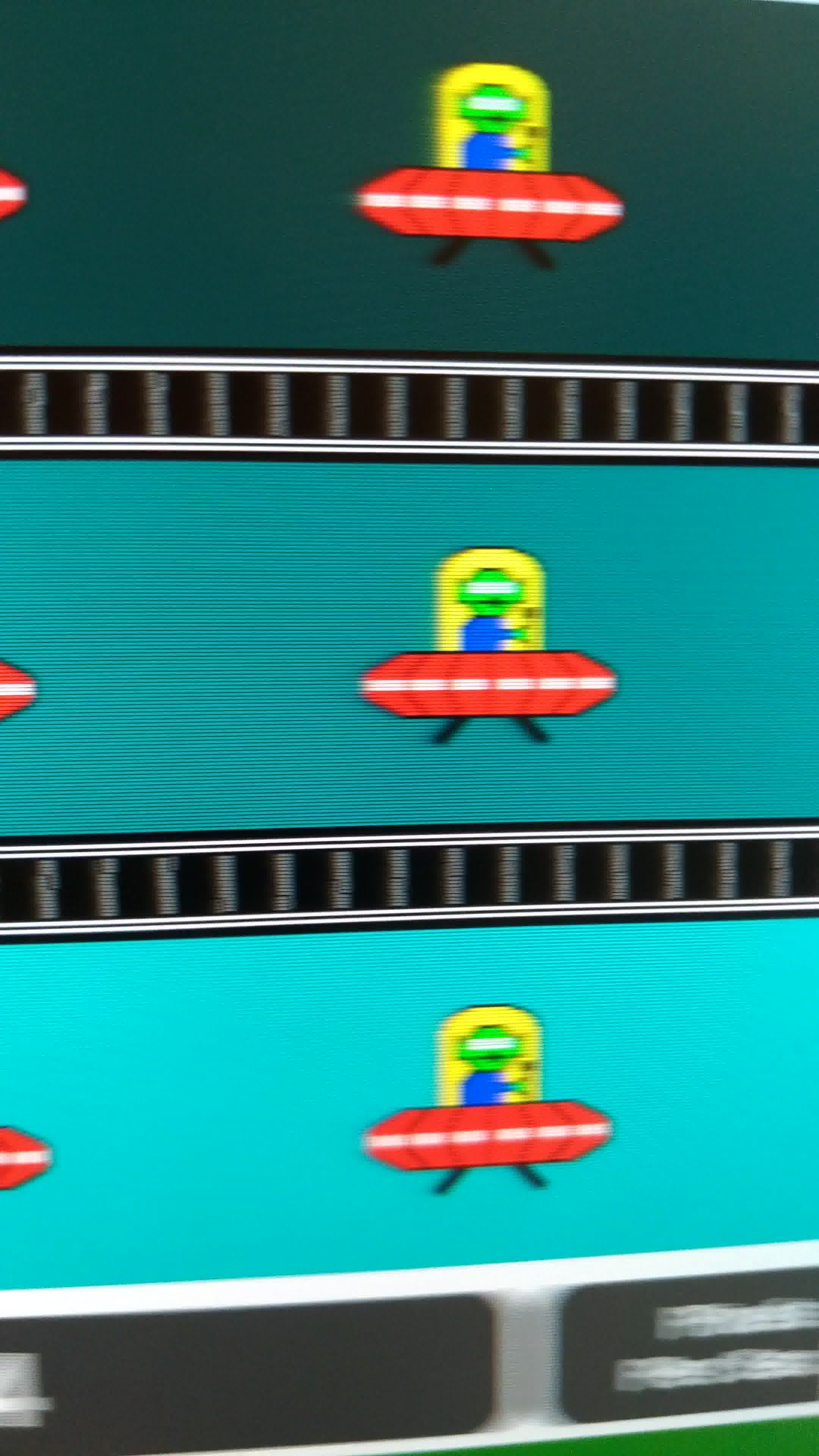

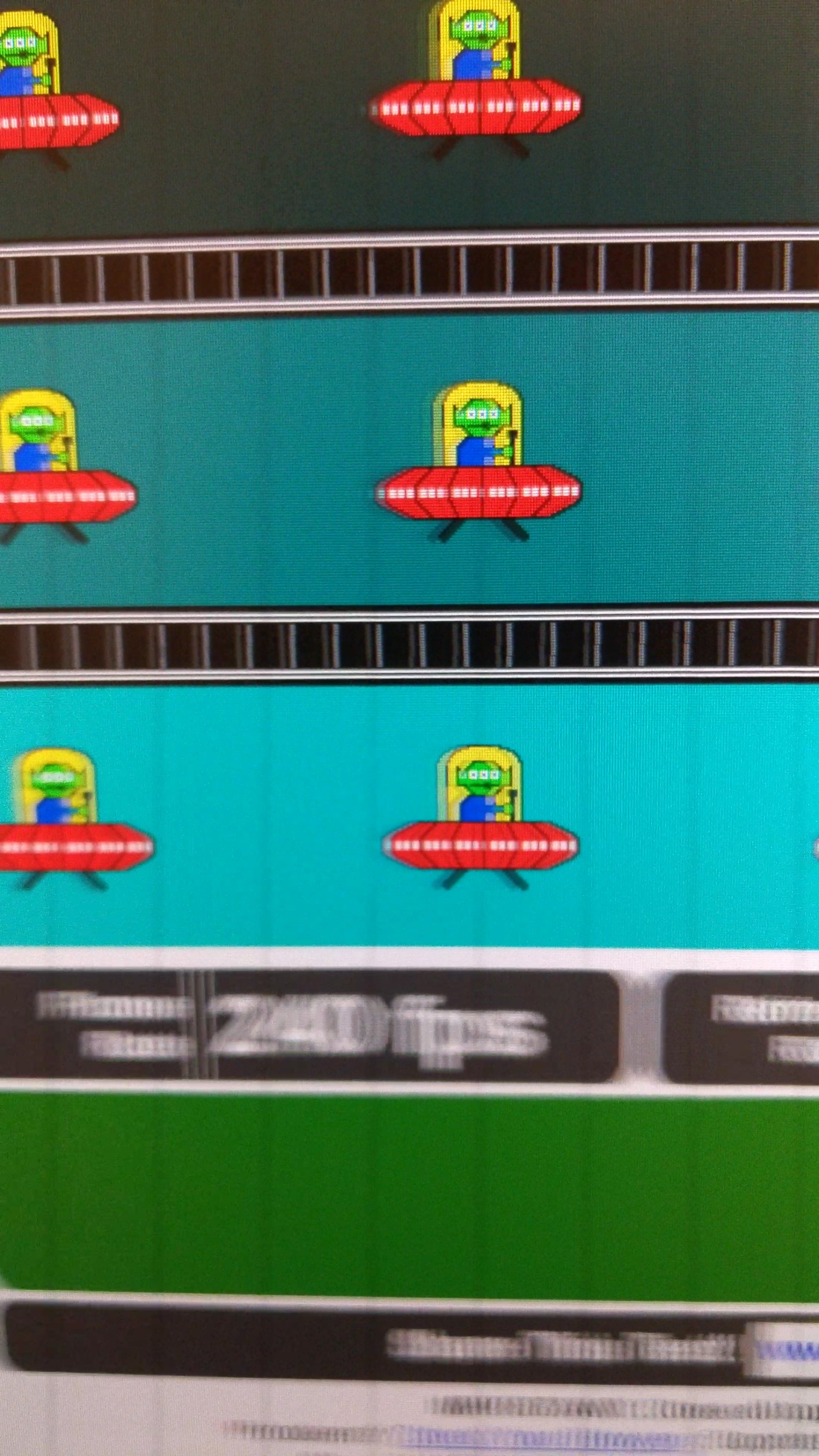

Attaching Out of the box calibration report, and 2 testufo shots.
ootb calibration report, max brightness, goes downto 75 nits. Gamut coverage and volume Strobed 240hz at the highest (dimmest) strobing value, sorry forgot to use the proper screen. Apparently theres a 3 image limit, so ive posted the non strobed testufo to imgur: https://imgur.com/a/Ux5XX9z
I might check the other shots i took for a better one, but this one should show the non-strobed performance decently.

Axaion
- Posts: 35
- Joined: 28 Feb 2020, 00:32
Re: AOC 24G2ZU 240Hz IPS mini review
its nowhere close to an HP x25, i had the x25, and 25f, the 25f i had was straight up awful, kyube has a mate whos x25f seems good.
for reference, heres the HP Omen X25 testufo provided by Techless (youtuber, check his stuff out!)
and heres the best shot i found so far with the 24G2ZU
