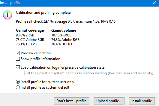

Colors; kinda eh, out of the box its way too blue, gamma is messed up, no setting saves the gamma - you NEED to calibrate it
Calibration does NOT fix all the colors.

Attaching Out of the box calibration report, and 2 testufo shots.
ootb calibration report, max brightness, goes downto 75 nits.
Screenshot 2021-10-18 at 11-59-34 Measurement Report 3 8 9 3 — 24G2W1G8 -1920, 0, 1920x1080 — 2021-10-18 06 16 58.png
Screenshot 2021-10-18 at 11-59-34 Measurement Report 3 8 9 3 — 24G2W1G8 -1920, 0, 1920x1080 — 2021-10-18 06 16 58.png (233.94 KiB) Viewed 16006 times
Gamut coverage and volume

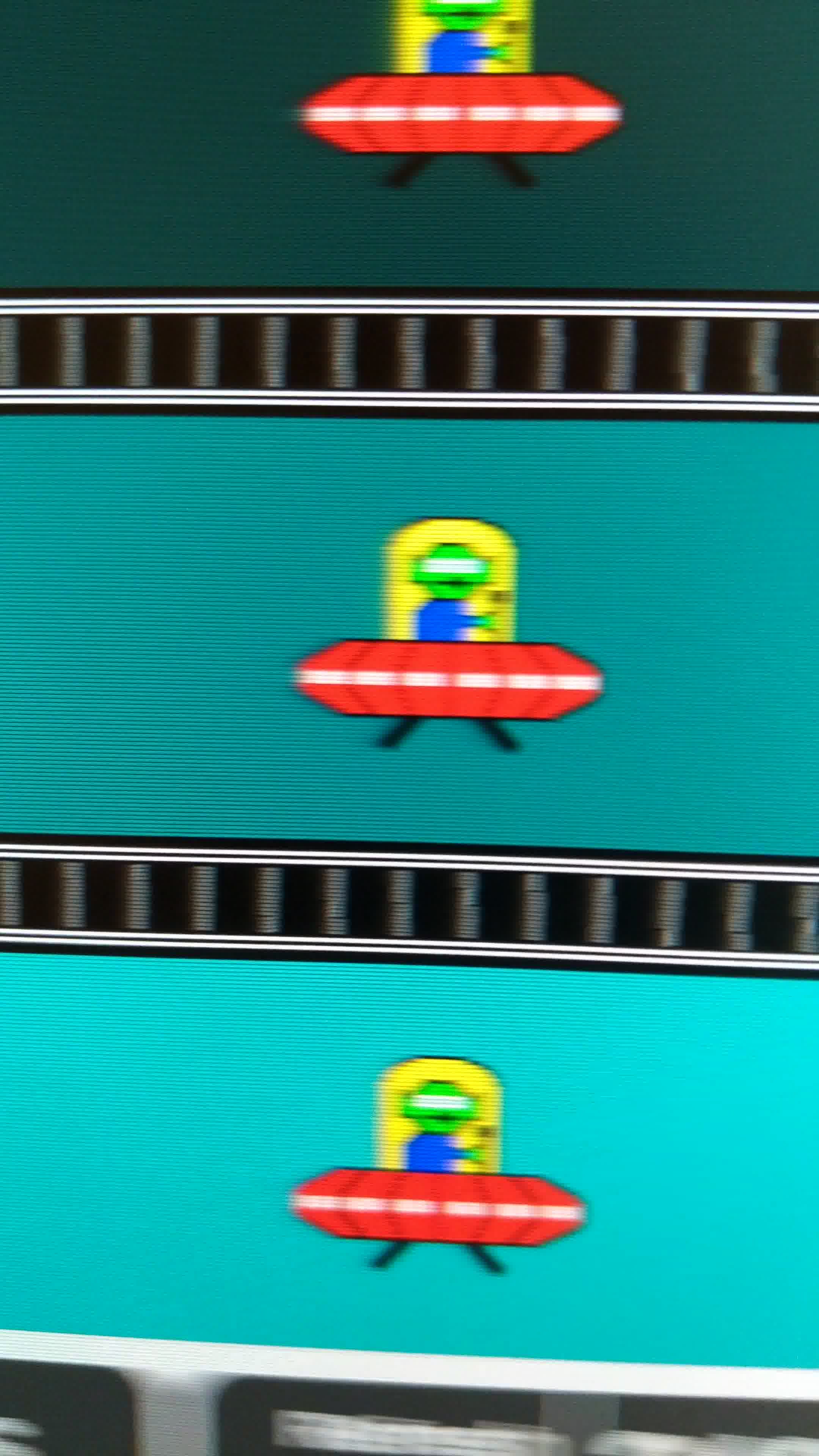

Strobed 240hz at the highest (dimmest) strobing value, sorry forgot to use the proper screen.
24g2zu max strobe 240hz.jpg (1.25 MiB) Viewed 16006 times
Apparently theres a 3 image limit, so ive posted the non strobed testufo to imgur: https://imgur.com/a/Ux5XX9z
I might check the other shots i took for a better one, but this one should show the non-strobed performance decently.

What is the overdrive used in non-strobed image and is it locked with strobing enabled?

all the shots were on strong, overdrive honestly didnt seem to do much at all.
there is aboost option, but only available at below 75hz for whatever reason, didnt try it
fairly sure overdrive was not locked

Yeah that's what I wanted to comment. On strobed displays it can be easier to spot overshoot. But this monitor seem to have no overdrive applied or it could be very subtle. Maybe it does something for the lower refresh rates like 60Hz. Overdrive behaviour can also be different depending on the gpu u use, amd or nvidia.
'Boost' on AOC monitor is usually MBR (strobing). Do you mean 'Boost' is available below or above 75Hz? Can it do strobing at 60Hz?
