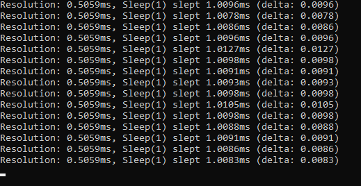

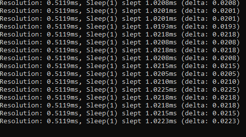

No matter what CMD prompts i use or whatever i do, my timer resolution is always 0.0001 lower than what i set it to.
This is really really weird and idk if it affects anything, but i really wanna know how to fix that or the reason.
Also in LatencyMon the latency is measured down to decimals 0.16546 0.56323 etc. and i remember before fresh windows install (i have windows 10) it was just natural numbers (im not sure though)
I use SetTimerResolution following this guide: https://github.com/amitxv/PC-Tuning/blo ... -precision by amitxv

Yes brother i have HPET off in BIOS and device manager (On in bios + disabled in windows gives the same 0.0001 issue) and had synthetic timers disabled.
bcdedit enum.png (2.26 KiB) Viewed 9236 times
"bcdedit /deletevalue useplatformclock" does nothing as i don't have it in my windows (AtlasOS) -
An error occurred while attempting to delete the specified data element.
Element not found.
However "bcdedit /set useplatformclock no" turns it off, but does not help with my issue or change anything(?)
I had HPET ON before in BIOS as Fr33thy said u should (source)
However this dude says otherwise so i turned HPET OFF both windows and BIOS and found out that now i can lower my resolution to 5060 instead of 5120 with even better delta. Still of by 0.0001 though :roll:
