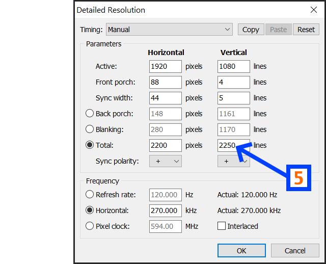

Now remember it's important to download CRU custom resolution utility, it will come with 4 files
Actual CRU file allows you to go to edit on the XG2431 and change the Large Vertical Total first put the monitor on either 60hz or 120 HZ and then you can change it
On 60HZ when you change windows setting you will see something around 1100 for vertical total, change it to 4500 make sure it's on 60HZ if you putting in 4500 do NOT go above that and make sure at the bottom of CRU the refresh rate is also set to 60HZ
On 120 HZ when you change your windows setting you can change the vertical number from 1100 or so to nothing more than 2150 do NOT go above 2150 just put 2150 for 120 HZ
Then click ok or save which ever option you get and exit, in CRU folder there is "Restart64" double click that it will restart your GPU instantly while inside windows, IF for any reason the screen remains black and no image comes back up press F8 on the keyboard this will take you to windows safe mode restart there will be a file called "Reset" in CRU folder you double click that to reset everything so the monitor will go back to range and restart PC. You can also use a second monitor to fix it.
Note once you stick to 4500 for 60 HZ and 2150 for 120 HZ for vertical total you won't have any issues with black screen.

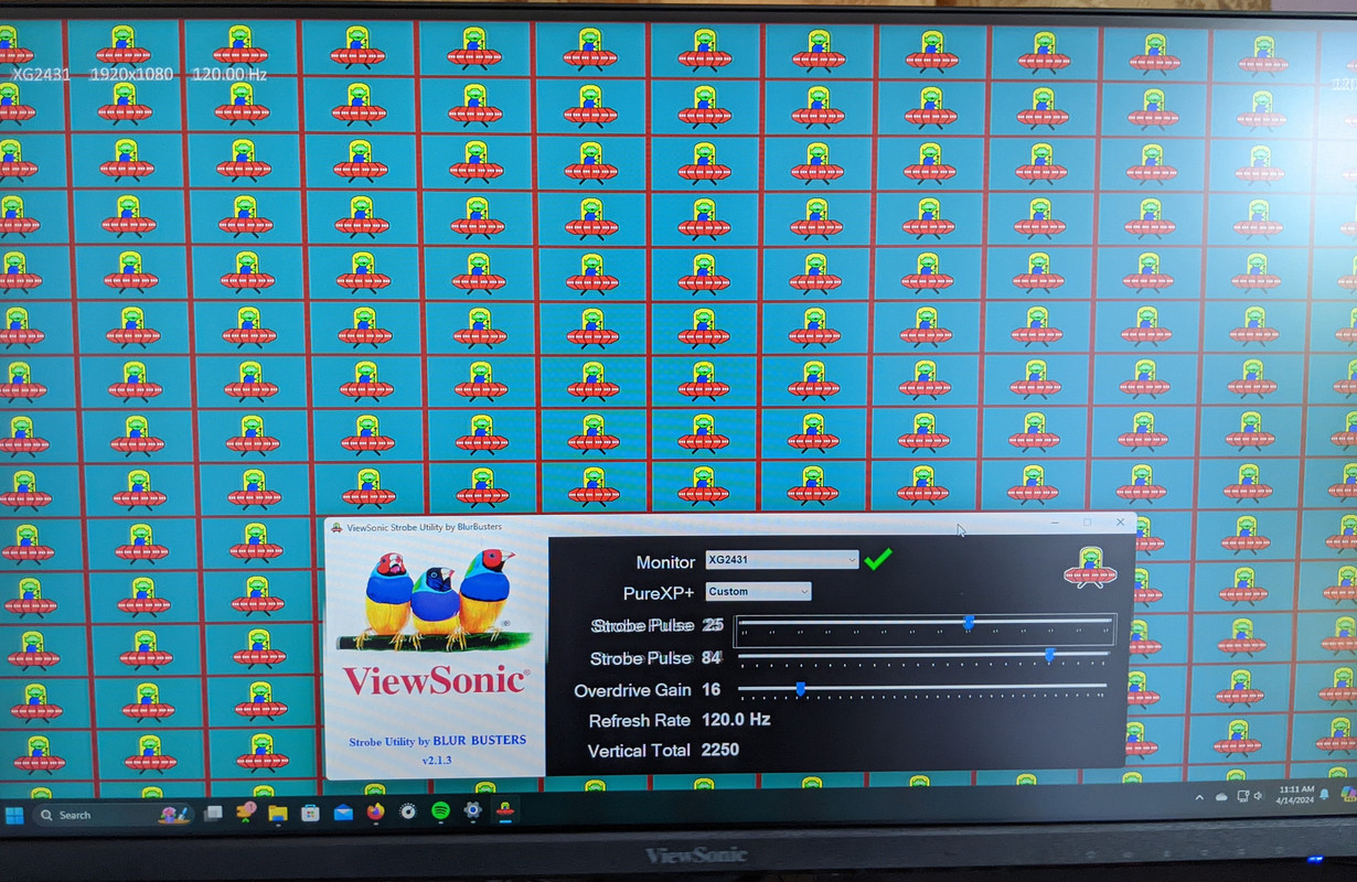

After this you open viewsonic strobe utility from blur busters and adjust the pulse phase slide the slider to the right for 120 HZ I use 70 number and for 60HZ I use 63 this is for max brightness pulse width. And overdrive don't forget that one
It's incredibly simple to do this strobe utility part.
This will almost completely eliminate cross talk to the naked eye when gaming.If you reduce the pulse width making the screen dimmer for clearer strobe you again need to adjust the pulse phase slider to readjust the cross talk for top and bottom of screen.
Don't listen to anyone telling you that the XG2431 isn't fast enough it's more than fast, the minimal cross talk at 120 HZ won't be noticed in game it's too minimal to see it when playing a real game.

I just want to correct one error I made, apparently you should never modify the HZ in the CRU, just as chief said in his guide this is why I wasn't able to get more than 2150Liu wrote: ↑14 Apr 2024, 09:38Got it, thanks!Supermodel_Evelynn wrote: ↑14 Apr 2024, 09:02^ yes absolutely the XG2431 beats the Zowie dyac monitors it also beats their new DYAC 2 monitors cause DYAC 2 has a lot of cross talk at 120 HZ and is unplayable in 60HZ setting
viewtopic.php?t=8946
Also here is Chief's official guide on the Large Vertical Totals to eliminate cross talk he has some pics on it to show what the software looks like also I know he uses 2250 but I get a black screen if I use over 2150 so thats why I said 2150
You have to change refresh rate in CRU "frequency section" all the way to the bottom to "horizontal" and select the "totals" radio button and ONLY modify that where it says vertical you change it to either 4500 for 60hz OR 2250 for Vertical and this automatically changes the HZ refresh rate.
60 HZ has total free cross talk absolutely nothing you can notice.
100HZ does NOT it has same amount of cross talk to 120 HZ when I tested it on mine so therefore here is my settings for 120HZ with extreme minimal cross talk top and bottom note you cannot even notice any of this in game
If you want full brightness just adjust strobe pulse at top all the way to max and strobe pulse bottom to around maybe 70
Here are the screenshots I use for all my settings where I get extreme minimal cross talk at 120HZ and No tearing with scanline sync
For 60HZ just change the 2250 to 4500 click ok, change windows settings to 60HZ and double click restart GPU
