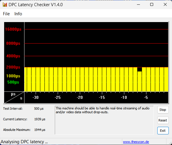

Something is off with my PC, whether it be an online or offline game vs simple AI, they seem to move faster than normal, its made it hard for me to land any skill shots on players, or avoid them to begin with. I Assumed it was an issue with the timer resolution so i set it to 0.5 (confirmed by checking measuresleep) and that didn't fix the issue either. Any boss fight i go through, the AI always seems to undergo its recovery frames faster, and the fights tend to always end up in the corner, in a game like Lies of P for example. I went back to my older quad core PC from 2012 and i didnt have this issue, i even performed better on that than the new one which doesn't make sense.
Things that ive tried:
1. Setting timer res to 0.5
2. Turning HPET off
3. Various bcdedit commands such as ''useplatformtick yes/no
My Specs:
i9 12900kf
gigabyte z690 aorus tachyon
rtx 4070ti
xpg ddr5 5,200mhz
os windows 11 23h2
attachment=0]Untitled.png[/attachment]
Also I can't seem to get my DPC Latency lower than this, is there anything i can do?

that is bad result, in perfect state you need get 500-1000.
try to set timer res 0.5033
all bcdedit deletevalue

DO NOT SET THESE BCDEDITS IF YOU PLAY ON W11
W11 do not reque any bcdedits, you can broke your system after take that.
use default bcdedit + set timer to 0.5033 (if you use new gen intel) +
Code: Select all
[HKEY_LOCAL_MACHINE\SYSTEM\CurrentControlSet\Control\Session Manager\kernel]
"GlobalTimerResolutionRequests"=dword:00000001
if you play on w10, play with open dpc.lat.cheker + set timer to 0.5033 (maybe you need set 0.5034 to work it)
open dpclat on w10 = GlobalTimerResolutionRequests on w11
and try bcdedit /set disabledynamictick yes / but your mouse can be floaty after that (but smoothly)
on your graph some driver can cause that.

I'm guessing you have mouse input lag and you don't realize it.
