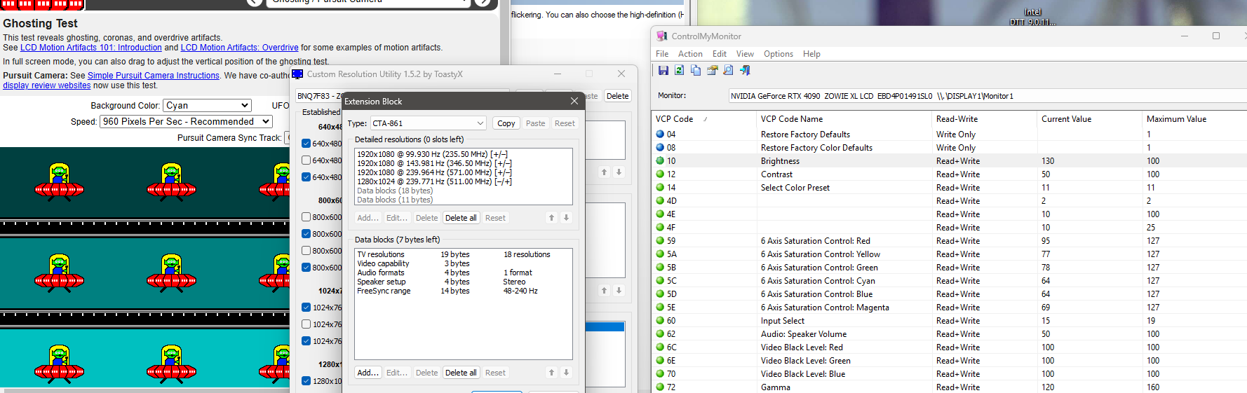

can someone pls share the default timings for the XL2546K ?
mine look a bit weird:

here, with controlmymonitor app you can exceed max brightness of 100 with dyac, 130, similar to the blur buster utility tool that makes dyac brighter
Screenshot 2024-12-13 181516.png (17.54 KiB) Viewed 2013 times

can you also post the 1080p timings in the extension block?

I decided to check it on my monitor XL2546K
matrix - DI Q250HTN00 A600 (The matrix itself is from 2022, the monitor is from 2023)
I can increase the brightness, but I've reached 200 and don't want to go any higher. What's the limit for this matrix, and could the matrix be damaged if I use a brightness of, say, 150? Or could this somehow affect the lifespan of the matrix?
