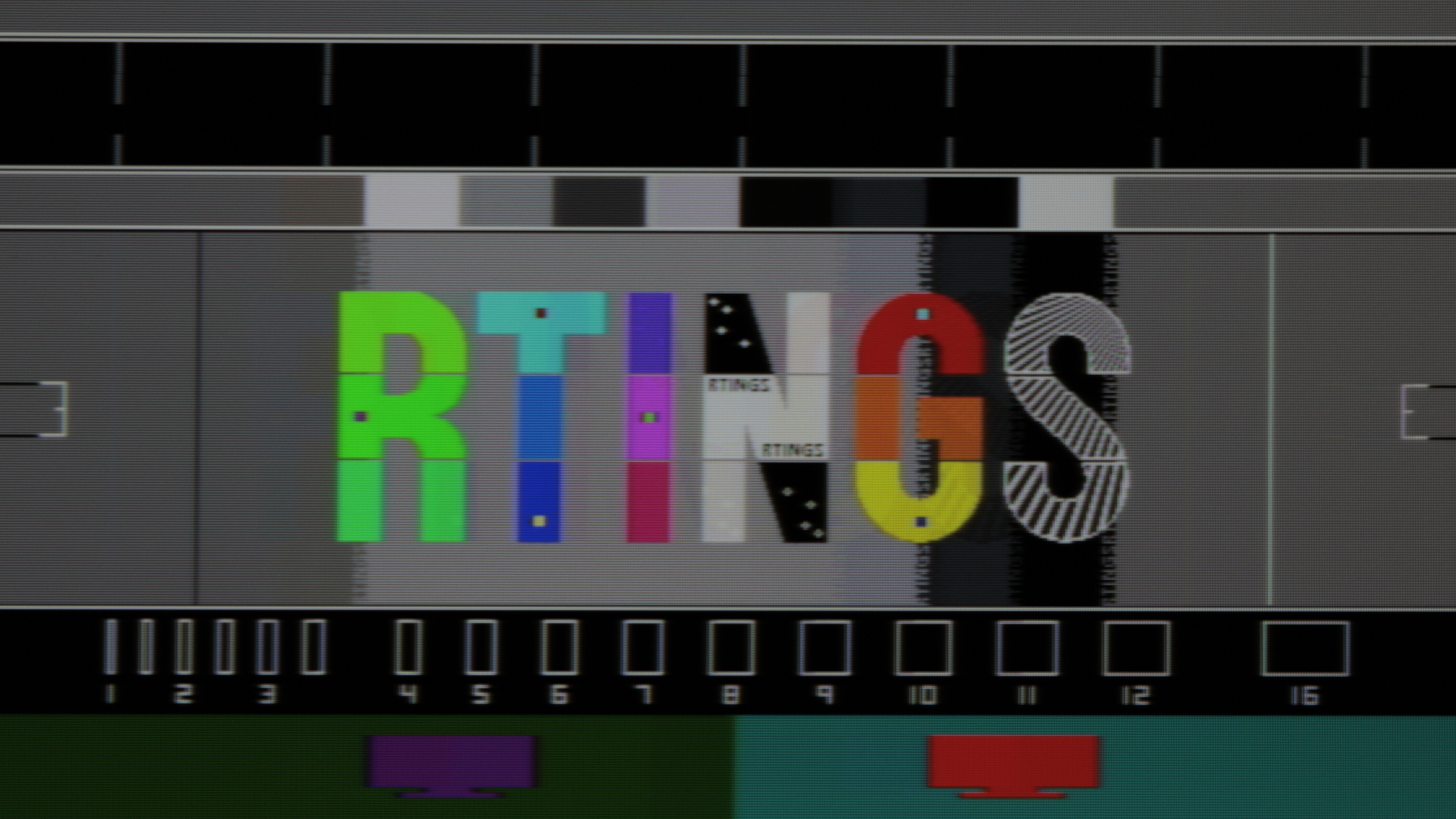

I think the RTINGS test is made at 2000pixel/sec, therefore it is really hard for a display to get it perfect,
it would need to be ~0.5ms MPRT.
My estimation is that the brighter QN90D test is a bit over 2ms MPRT (480hz sample & hold OLED test look slightly clearer), but that darker QN90F test is noticeably under 2ms MPRT. I would consider that test picture to be "near perfect", I'd have a hard time eye-tracking beyond that level.
I don't know if the QN90D was tested at full brightness and the QN90F was tested when calibrate for dark room SDR. Not to mention, on the QN90D outside Game Mode, BFI is capped at a much lower brightness, which leads me to favor interpolation + lower brightness/pulse width trick instead. Many things that we now know about Samsung LCDs can explain the brightness/clarity discrepancies between their RTINGS BFI picture tests.
In any case, the QN90D is badass because at Game Mode BFI max brightness, the motion clarity is already better than GX/CX or Plasmas, with enough brightness left for >HDR400.
If you want to go even beyond, the closest to CRT currently possible on a TV, you have to be OK with being limited to dark room SDR brightness. But it's already nearly 3 times clearer than the CX/GX Motion Pro High at the same brightness...
Of course it's ok to "deduct points" due to LCD artifacts that affect motion: some have more ghosting than others, KSF phosphor trails bother me on my PG27AQN,...
So if they gave us a rolling-scan OLED that does ~3ms MPRT at 60hz, then I guess some people would prefer that over a ~1.5ms LCD...
I really truly want both.
Sadly though, we got robbed of that and I believe that manufacturers will start competing on low-lag interpolation instead.
Curious to see that as of right now Samsung is the only player in town, both for low-lag interpolation and LCD strobing.
Can't wait for LG to get with the program so we have some competition.
Since we're bringing back BFI picture test, I think it's a good thing to put into perspective a few relevant shots in order from blurriest to clearest (QN90D probably matches the QN90F when brightness is lowered):
-LG G1 OLED (60hz Motion Pro High - 158hz equivalent)
-LG GX OLED (60hz Motion Pro High - 240hz equivalent)
-QN90D (60hz LED Motion w/ high brightness)
-PG27AQN OLED (480hz sample and hold)
-XL2586X LCD (540hz sample and hold)
-QN90F (60hz LED Motion w/ low brightness)
Edit: it's hard to tell that the QN90D is noticeably better than the GX, but when you compare the QN90D using the picture from the old test protocol using web archive, you can easily tell, and you can find these in the early posts on this tread.
