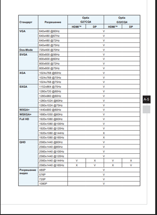

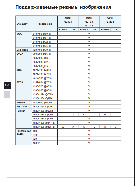

I've tested a lot in the CRU program and also decided to try what you suggested. The screenshots show that we have a similar situation with monitors, but I have a 1070ti video card, I set it up as you described above, but only the standard one works when locked, RB breaks the screen image. I set it up as standard, tried playing, well, yes, smoothness appeared, but CS stopped launching, sometimes in full, sometimes with black bars, and so on. It added a little smoothness but didn't fix the aiming from head to head, the accuracy remained the same. As a note to the author, try testing the game at 4-5 in the morning, maybe you will feel like you've become better at playing, and this is true, but still, thanks to the author, I had a small but hope.
- 333.PNG (68.95 KiB) Viewed 3896 times
- 2.PNG (67.57 KiB) Viewed 3896 times

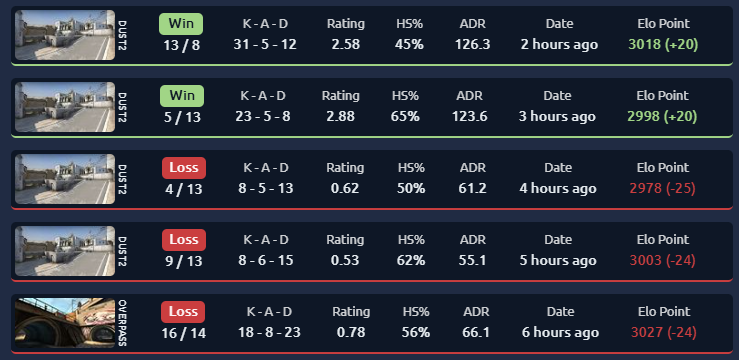

Also here you can see my last 5 games on Faceit where I was still testing my AMD/Monitor settings, I think u'll notice the difference:

I don't like playing CS2 on 1080p resolution, that's why I'm playing on 1280x960 stretched. If i try to open CS2 with 1280x960 resolution without custom resolution I'll have black screen, that is why there are only two options for me, gpu scaling or display scaling using custom resolution. Both methods have to be properly configured.amorou wrote: ↑26 Oct 2025, 17:06Your monitors edid has native resolution at 240hz , so if you play at that resolution , how its different from you adding 1280x960fjoecs wrote: ↑26 Oct 2025, 16:39I didn't try other resolutions as I always play on 1280x960. I don't change my in-game settings, only testing windows tweaks. What is more, it wouldn't fix this issue as I had amd and monitor settings that interfere with each other.
