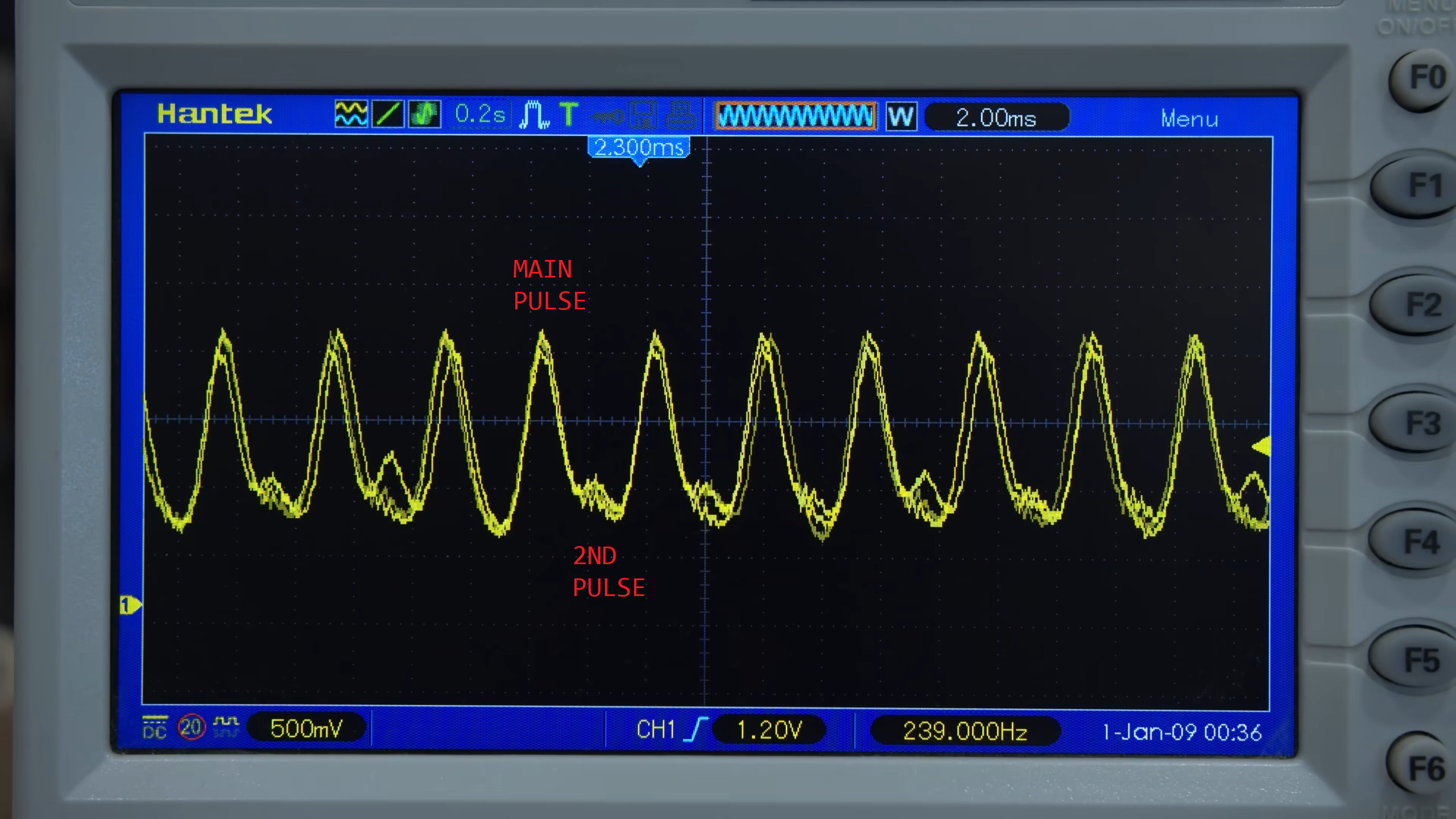

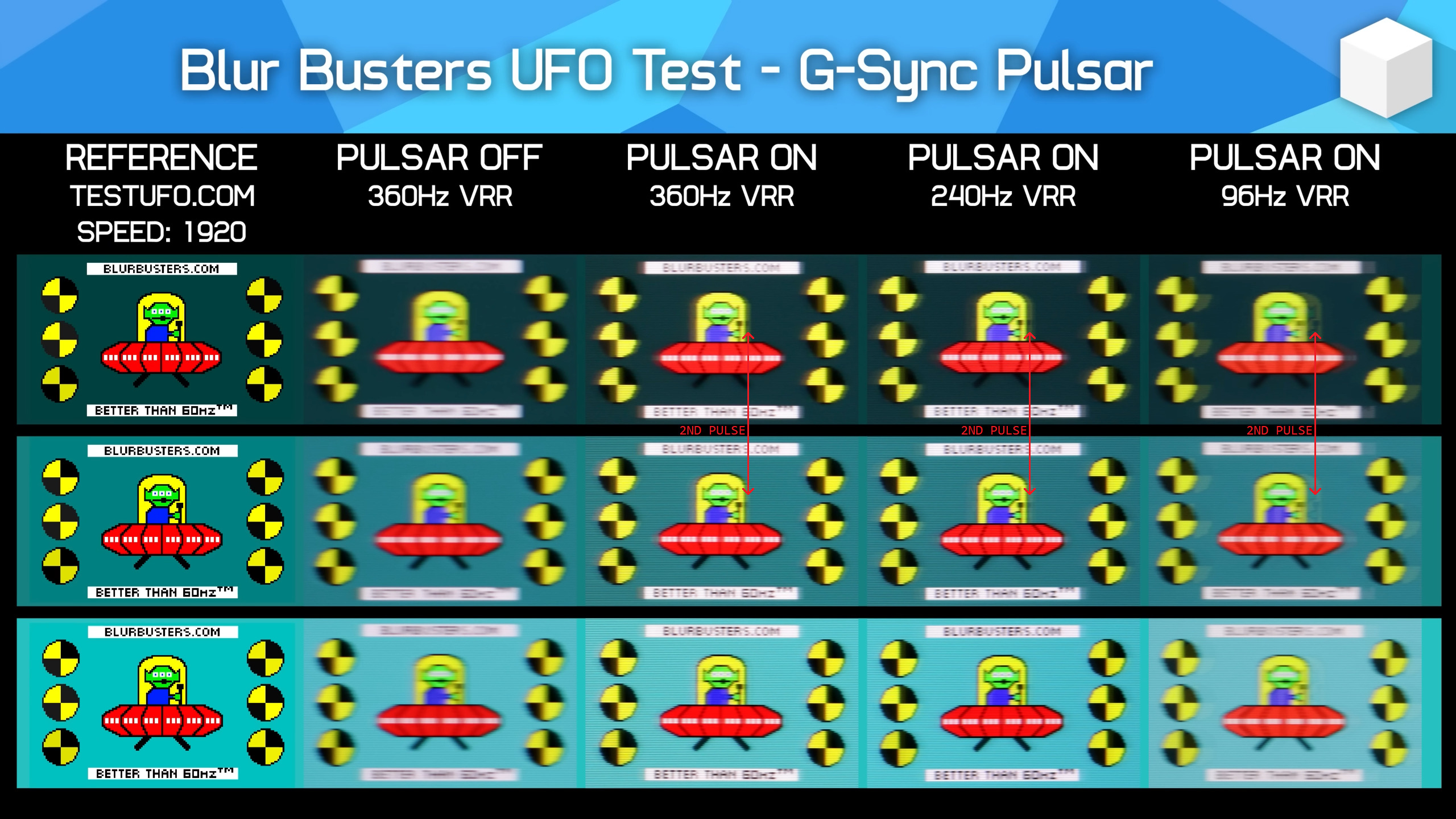

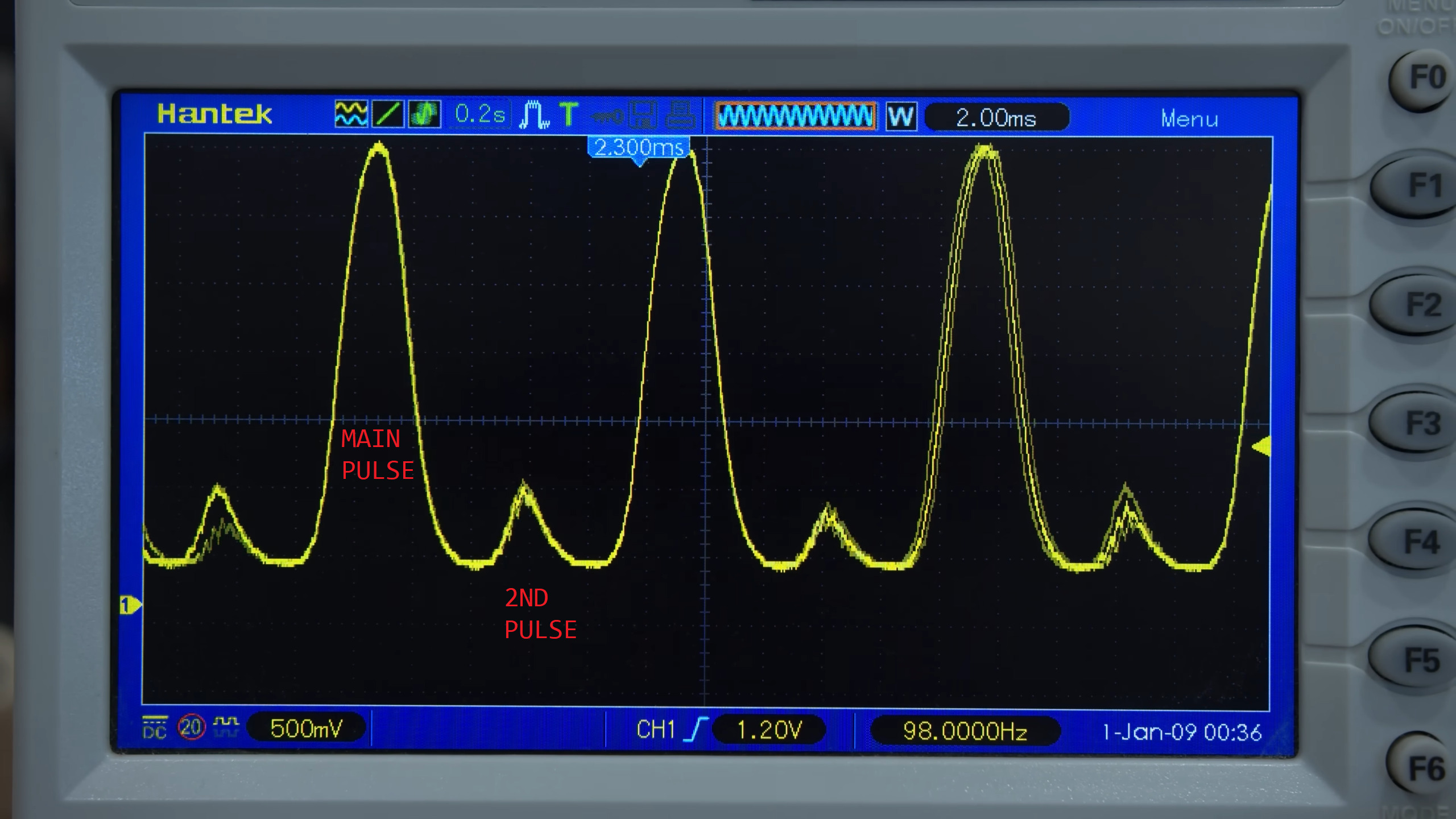

OK so turns out the secondary pulse they're using for the compensation is actually spotable. I just realized MUB ufos are moving at faster ~1920 and not 960 px/sec as he said. On a classic single-strobe that would normally translate to wider spacing between the primary and ghost images, but they appear to be as tight as at ~960 px/sec. Which means the primary ghost image is coming from the secondary compensation pulse between the frames. So it's kind of a double-strobe VRR, but a softer one.

https://youtu.be/SXwXGYhi8_I?si=CwuSPdg4Yn_2P7ku&t=968
So if I'm thinking right ULMB (without g-sync) on these monitors won't have as much artifacts. Anyone tried it?

I actually have no idea why is there a second pulse. If they managed to pull off variable amplitude (pulse height), then why not let the main pulse do all the compensation? Chief, you here? May you chime in?

My expectation is that the second compensation strobe is the "high frequency" compensation that Nvidia's engineers were talking about when they said it took them a decade then they ran into an 'unsolvable' problem until they found this workaround.
The second compensation strobe is because if they compensated in the next regular main strobe instead, the human vision persistence wouldn't last long enough to hide the change in average luminance and you would see a change in brightness that would seem like a visible flicker.
That would align with the oscilloscope reading and the result Monitors Unboxed says about the screen getting blurrier during this compensation strobe. The secondary compensation strobe would essentially increase persistence and make a little bit of a double image leading to perceived blur which would be far less obtrusive than low frequency flicker.
