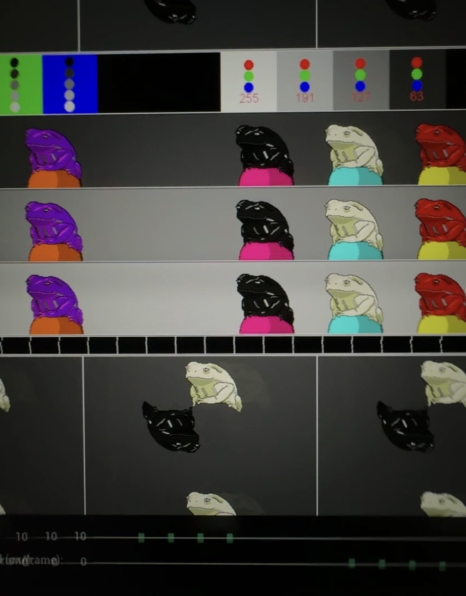

holy moly 120 global strobe is CLEAR :shock:
This is the best picture I got freehanding my phone at 4920px/sec (1/30sec shutter used) It's so fast that it's hard to get a fully clear pursuit outside of just the center of the photo.
There is very slight crosstalk showing at the very top of the screen and the lower ~1/4 of the screen. It's shown in the photo trailing the lower white frog (moving right to left), it's not at all bothersome to me especially with such a massive clarity jump.
I'll see how well I can do getting an mprt photo

is it brighter than the 60hz on 10 pulse level?
edgintheledge
Posts: 49
Joined: 03 Feb 2026, 02:11
Post by edgintheledge » 02 Jul 2026, 01:34
MSIfanboy wrote: ↑
02 Jul 2026, 01:27
:D
Feels about the same to me flipping back and forward, I don't have actual hardware that measures the nits for sure.

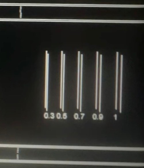

MPRT photo of 120hz ULMB 10PW
Using 5760px/sec to get the 0.3ms bars!
We are at the speeds where you can barely even keep up with your eyes. Definitely very happy with the addition of this mode :D
