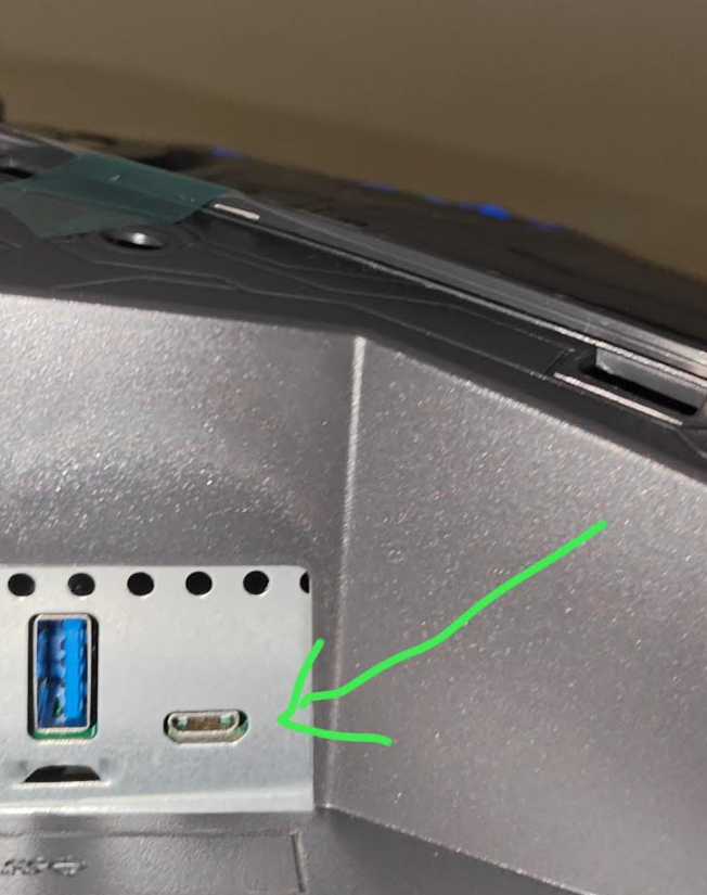

i was confused to at first, you need a micro usb cable to update firmware, its the small hole far right from looking at the back of the monitor
NOT USB C, MICRO USB, like the old port used with like galaxy s7 and below
the firmware update page doesnt even show anything in regards to needing micro usb
Screenshot 2026-07-05 074856.png (495.64 KiB) Viewed 248 times

Post by daviddave1 » 05 Jul 2026, 06:26
you need a good cable the one i had did not work. I bought this one from amazon for 1,5 euro https://www.amazon.nl/dp/B07CWTTX65?ref ... title&th=1 works like a charm.
