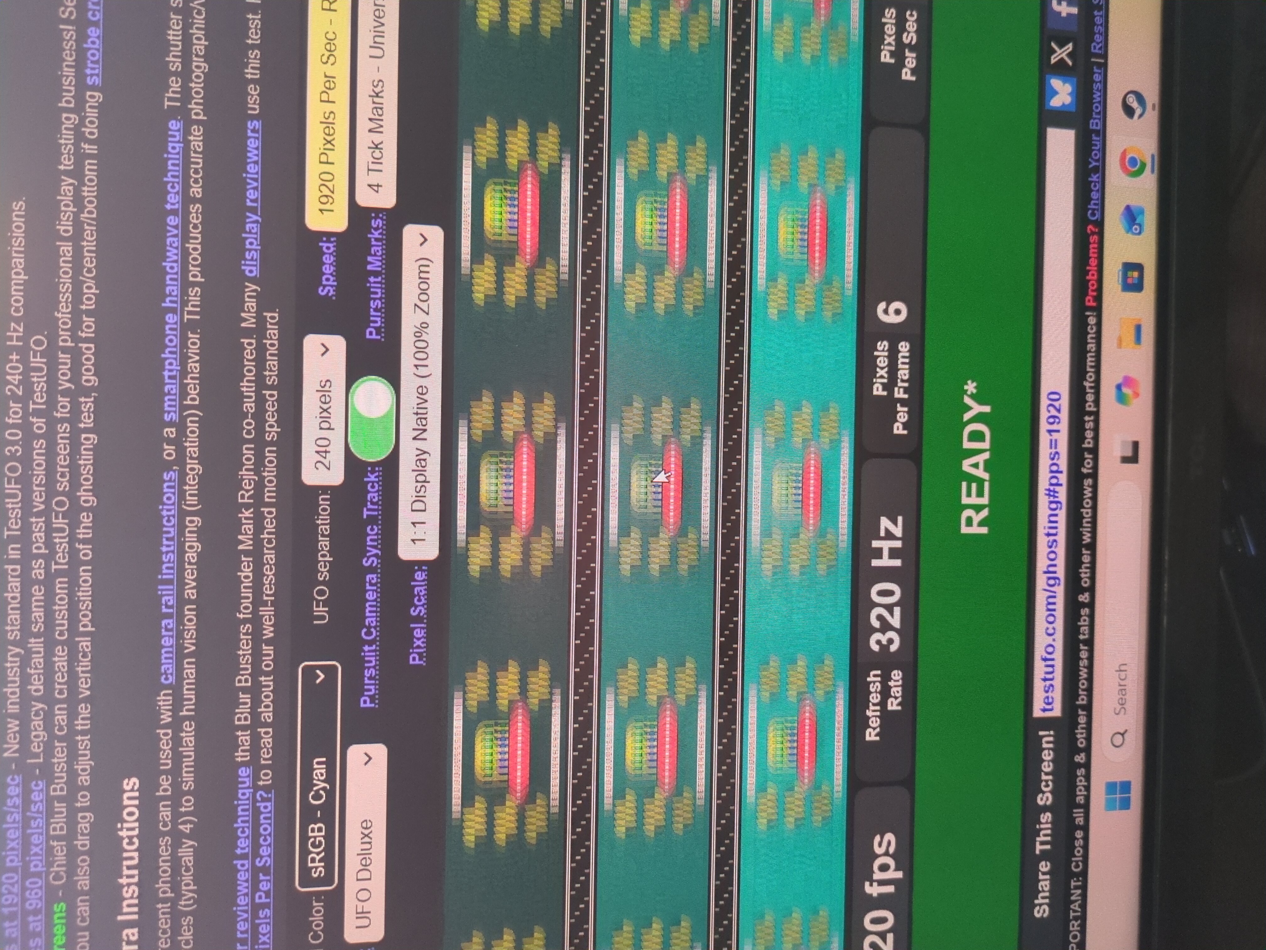

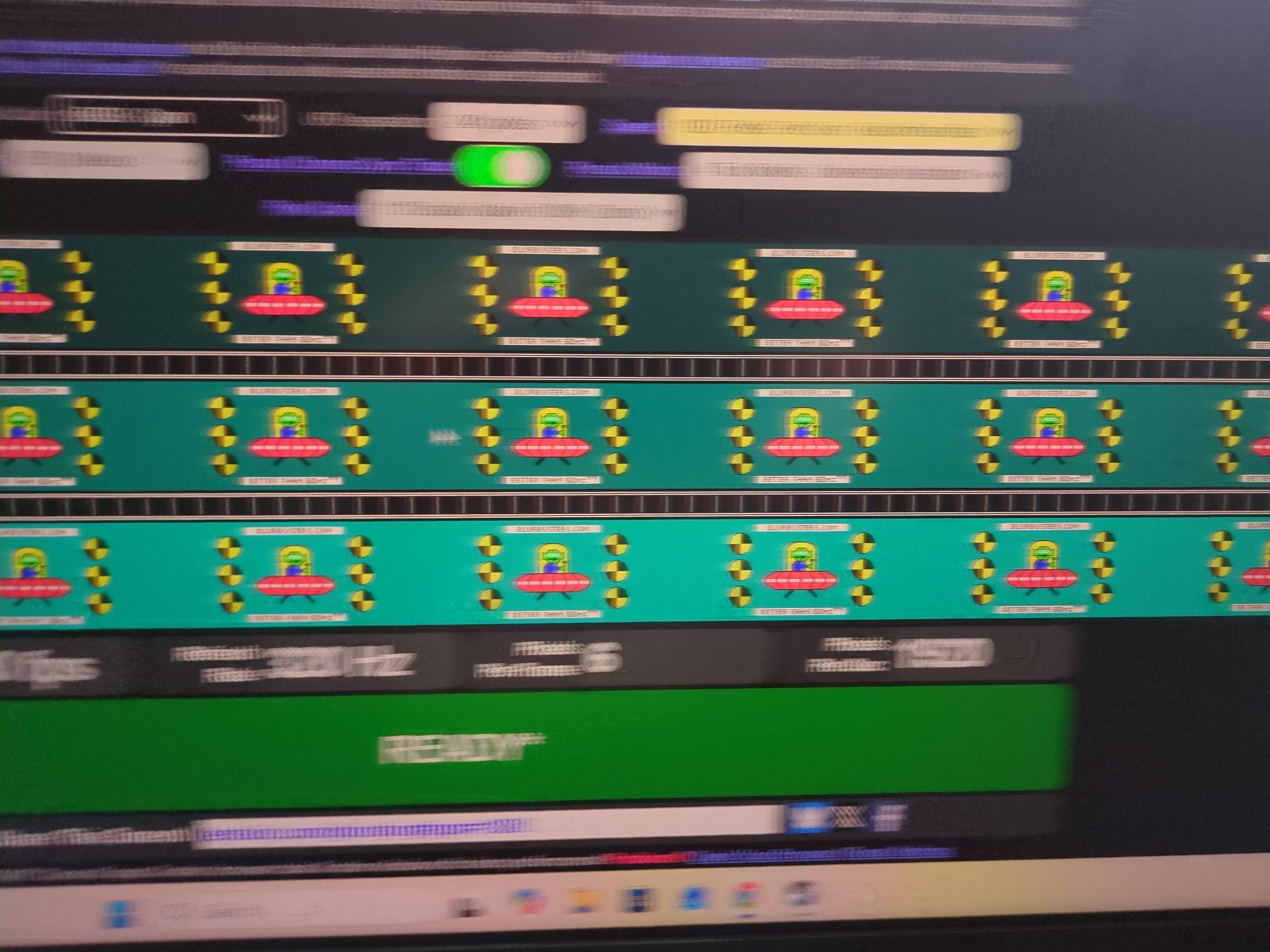

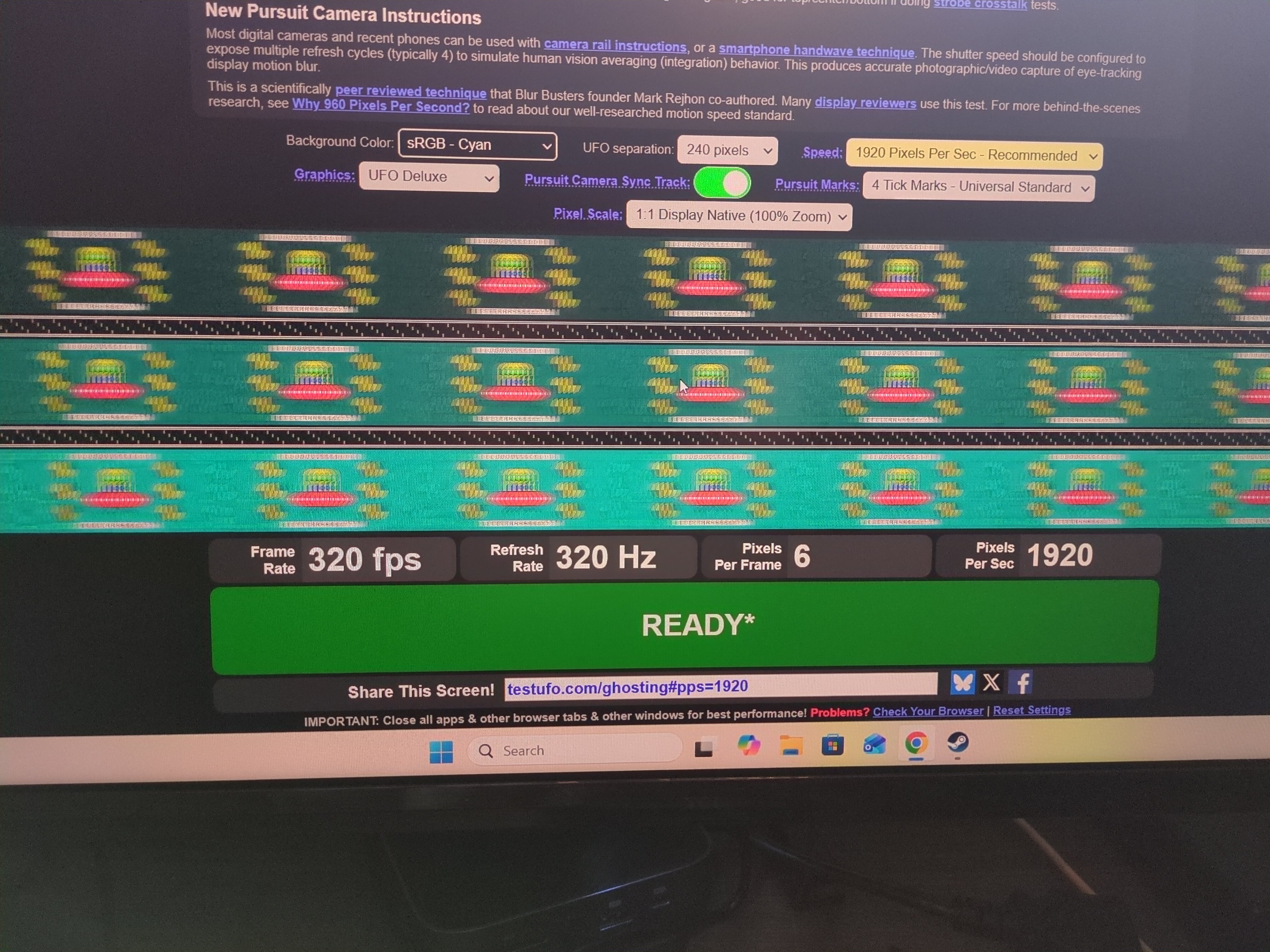

I must say, it isn't that bad today. Still notice it though. It also stays sensitive for some days so I'll try the monitor a bit more.
It's definitely different than my YAG based monitor and work YAG monitor.
I tried to do the UFO test and capture it with the instructions. Kinda difficult and had to download a camera app to set the shutter speed.
I also made a video but can't seem to upload now cause the file is too large. If you want that as well I'll do it later.

That's definitely a QD-based LCD, as there's no KSF fringing when using "MPRT Plus" (whose performance I'm disappointed with...)
