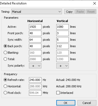

Can you please give me the best CRU settings for this monitor? I saw in another post, that you got this monitor too and I'd like to optimize it with the best settings. Unfortunately I really haven't figured out how to use CRU properly yet. All I did so far was increasing Vertical Totals to the max (1200) so it stays just under 600 Mhz Pixel Clock (599.04), because I read, that it improves the Blur reduction mode. I use Aim Stabilizer with this monitor btw so please keep that in mind if you can give me better CRU settings. I'll attach a screenshot of my current CRU settings.
blur busters kd25f.JPG (36.99 KiB) Viewed 12311 times
