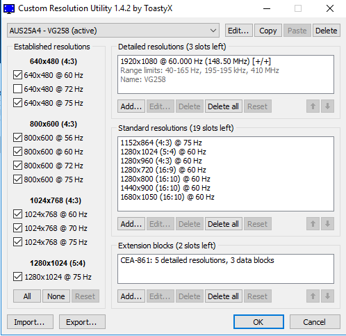

Yoo dude! Thank you for your reply i really appreciate it! :D
So i downloaded CRU but i dont know what to do now.. Could you help me please?
I also attached a screenshot of the CRU window that i have.

Yes of course.Happy to help.I hope result makes you satisfied. :)
So you see Extension blocks.Double click that.New screen comes.Double click 1920x1080 165 hz from detailed resolutions.New screen comes.You see Timing.Enter that and select Automatic Lcd Reduced.Then press ok.Another ok.And then another ok.Next step will be to reset or shutdown your PC.Then turn your PC on with new timings and test in games. ;)

Okay i did everything u said bro, the only problem now is that it's hard to tell if it's better or not..
