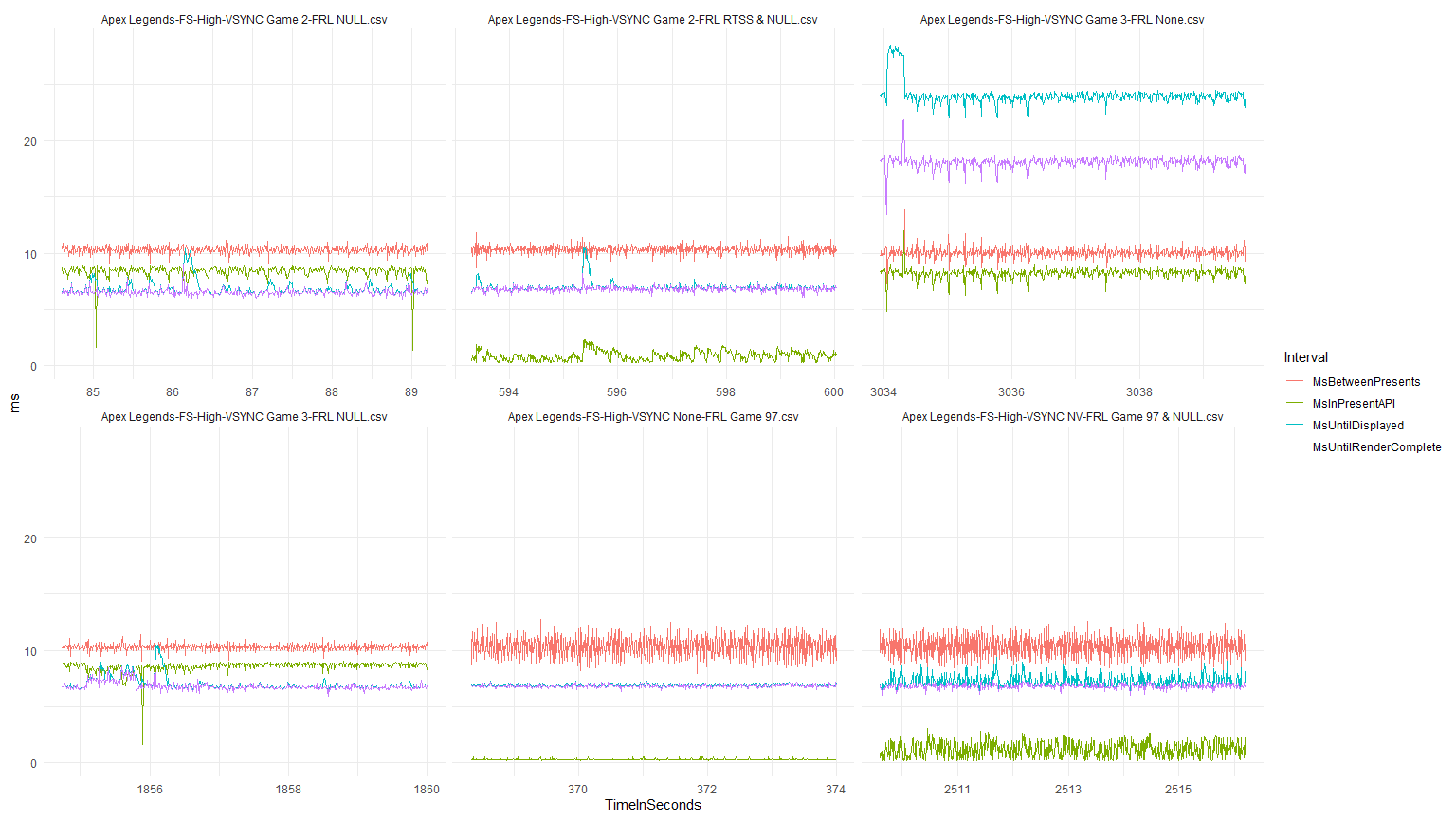

I made the following plot for several traces of Apex Legends with various settings. The MsUntilDisplayed measure (blue line) essentially is the component of frame latency caused by the present pipeline. It's clearly much higher in case VSYNC is ON and the game hitting the refresh rate (100Hz); ie. the top-right graph. In all the other graphs the latency component sits around 8-9 ms despite various different settings and limiters being used. Based on the end-to-end measurements though, we know the in-game capping results in a lower overall latency. PresentMon cannot see that difference, unfortunately. It would be great if we could somehow timestamp game inputs and connect those to PresentMon's traces... Maybe Windows ETW has a way to do it, I'm not knowledgeable enough to say, but I'll look into it.

I haven't tested Siege's in-game limiter, so I'm not sure, but I know for a fact that Overwatch's in-game limiter has lower input lag than RTSS, NULL and NVI, and is one of the better, more stable in-game limiters around. There's really no reason not to use it with G-SYNC:
As for whether some games work better with RTSS, that's highly dependent on the game in question, and whether you're using G-SYNC. RTSS is always going to have more stable frametime performance than in-game limiters because it limits by frametime, whereas good in-game limiters limit by an average framerate target, and let frametime run free, one of the very reasons they have lower input lag than external limiters, but this also means frametimes aren't as consistent. It's a trade-off.
Either way, G-SYNC stabilizes frametime well enough on it's own for you to use an in-game limiter over RTSS when available, if you desire the absolute lowest input lag.
That said, there are in-game FPS limiters I hear aren't great (like CoD MW), where you're better off using RTSS, but that's pretty rare.

Thanks for these. Looks like the way nvidia is limiting the framerate in NULL mode is different than their normal limiter.
