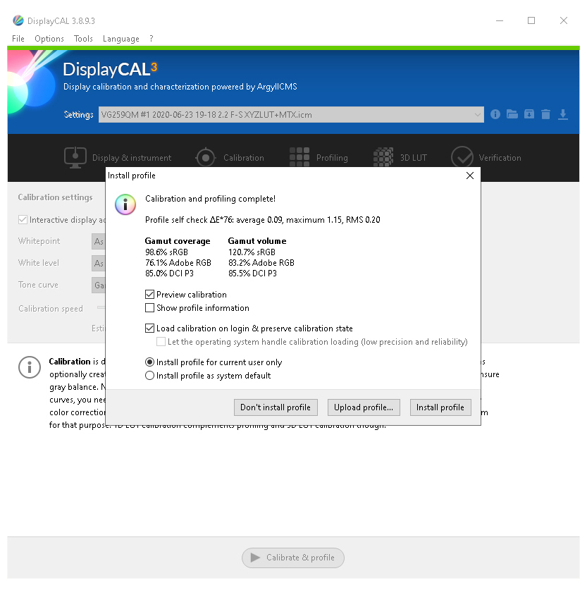

Post by Kryptik » 24 Jun 2020, 17:06
I calibrated my VG259QM and this is the result. It's much better than what was suggested in one of the Youtube reviews I posted earlier. I compared it to my older Asus Proart PA248 and they look pretty much identical. The monitor can also do 12 bit using HDMI at 144hz.
Asus VG259QM 2.jpg (230.83 KiB) Viewed 8958 times

Kryptik wrote: ↑
24 Jun 2020, 17:06
Those are some good results. I would still do a re-calibration however seeing as you haven't hit 100% of sRGB, I got pretty close with 99.4%. I am picking up the i1Display Pro on Friday and I'll do a re-calibration as well, I am hoping to hit 90% of DCI-P3.

Kryptik wrote: ↑
24 Jun 2020, 17:06
nice
do you have an srgb color profile to camp the gamut to 99% srgb?
