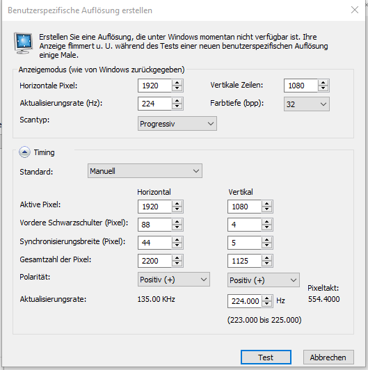

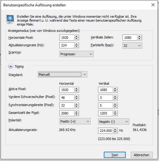

Re: [XG270] What's best settings to use for comp scene.
Hi Chief,
can you look on the screenshots I made and tell me wich one is the right setting? With my old BenQ I always just used the "reduced" timings and made the 1350-Trick after that.
But if I use 224hz, but the games I play dont get above 130fps then it makes no sense right? I put the Display into 120hz, capped the Framerate Limit to 119.99 in RTSS, enabled Fast-sync in NVIDIA-Control panel, and set pre-rendered frames to "ultra". Also I disabled VSYNC ingame (PUBG).
PureXP is at "extreme". So did I understand it right and this Display can put the Panel-hz for ex. to 224hz, but let the backlight strobe with another hz, like 100hz? Is that dependend in the PureXP setting?
revnu

- 2021-08-10 07_31_35-Anpassen.png (23.05 KiB) Viewed 8723 times
- 2021-08-10 07_31_51-Anpassen.png (23.92 KiB) Viewed 8723 times
