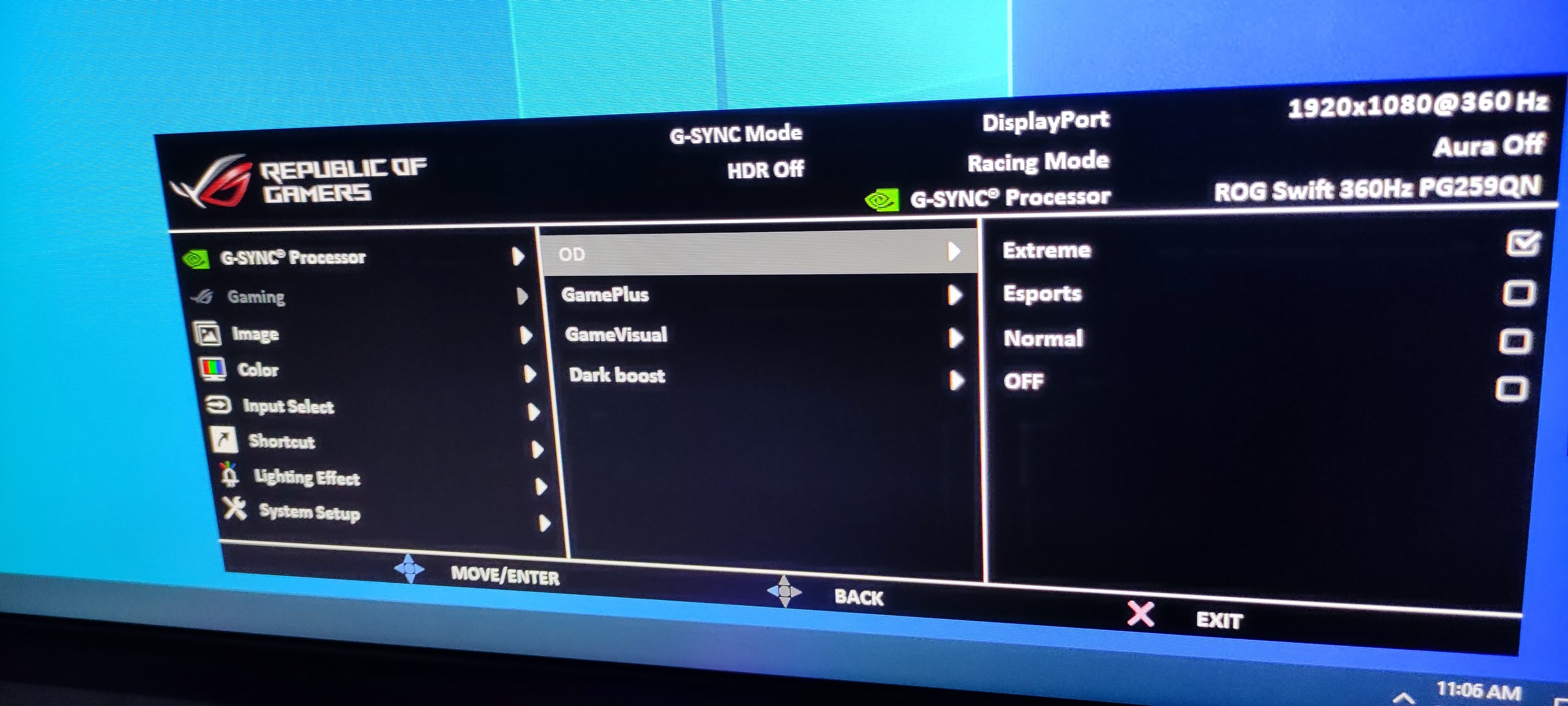

Hi guys,
Just bought this monitor yesterday and i see another setting in Overdrive that I haven't seen in any reviews:
It's called Esports. I am not able to find information about this anywhere. Is this something they have added in newer units with newer firmware?

It's just a label. They could have called it "high" instead. If you want to see the effect of the different overdrive settings, you can view this:randomgamer wrote: ↑12 Aug 2021, 13:07Hi guys,
https://www.testufo.com/ghosting
preferafably in fullscreen mode, and then change between the different OD settings. They will affect ghosting.

IMHO, there should always be a "User Defined" setting in all Overdrive menus nowadays, that allows you to adjust a slider (0 to 100%) that maps to the scaler's entire Overdrive Gain range.

Even a range from 1 to 10 would probably be good enough for virtually all intents and purposes. I suspect the reason we only get settings between 1-3 or 1-4 is not technical, but marketing. Technically, overdrive should be treated the same as brightness, contrast, color saturation, etc. But a slider with values doesn't sound as impressive compared to settings with "ultra", "extreme", "high", etc, in their namesChief Blur Buster wrote: ↑14 Aug 2021, 16:48IMHO, there should always be a "User Defined" setting in all Overdrive menus nowadays, that allows you to adjust a slider (0 to 100%) that maps to the scaler's entire Overdrive Gain range.
