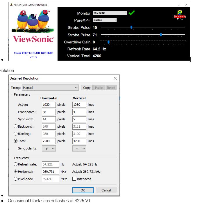

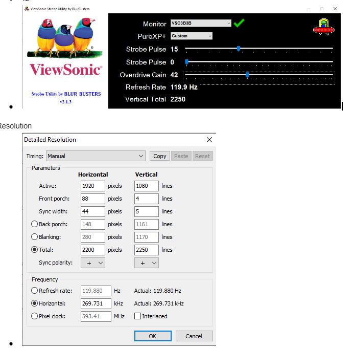

re-reading both the QFT how-to forum post and the xg2431 web article, I believe I'm following the instructions correctly. the native 240hz VT is 1125, but every VT I've tried above 4200 (including 4525) result in either no image, or black screens every few seconds. I also don't have any cross-talk on the last row of my "60"hz--that's entirely artifact in my image.
in looking at the panning map test, at 240hz the clarity difference between the strobing modes stands out a bit more but they're still very small increments and overall screen brightness is more noticeable to me. reading text is actually the only place within a game I feel like I perceive a meaningful clarity improvement with any of the 240hz strobe presets--albeit in an artificial environment as I drove around in a circle looking at some background signs in rocket league. I don't really think of myself as a fixed-gaze type player, but it's entirely possible that what I think I do vs what my eyes really do is quite different.
now, the panning map test at 6(4)hz and 120hz with QFT/custom strobe settings is clear as day. I did give both of those refresh rates a bit of latitude on screen brightness (15% persistence) but it's impressive nevertheless. that only reinforces my surprise that sonic mania (vsync on with a game pad) did not show similar (perceived) performance with my 64hz QFT/custom pure xp vs unstrobed. I went back and confirmed via monitor OSD that I'm at the correct refresh rate. I actually found a section with text that I could reliably run past at speed--sure enough, it's much sharper with strobing on. I still don't experience that "aha" moment when I enable pure xp, but I'll give it another try with other games at 120hz.
I've been playing valorant and apex legends (although the arena mode where framerate is far more stable) at 240hz with pure xp on normal. I have been bouncing around between vsync on, vsync off uncapped*, vsync off 240 cap. I definitely notice the fluidity gain with vsync on, but I also think it feels a bit less responsive. I'm not convinced that lag perception isn't placebo (vsync lag at 240hz should be what, at most 8ms?). I've been using a viper 8k at 3200 dpi, generally at 2000hz because apex doesn't like 8k. overwatch seems like a good test candidate so I'll add that in.
*this is 260-300fps, so not exactly overkill

In these special cases, you can move the radio button to the “Hz” and then edit the Hz lower. Usually this is acceptable once you’ve created a too-high-Hz QFT mode, so you can usually edit it into a lower Hz. Try that.
Follow existing QFT instructions, get your Hz as low as you can by making VT as big as possible, and once that fails, move the radio button to the Hz and then edit the Hz (e.g. edit 64 to 60 without changing any other numbers).
to make sure I'm understanding: when manually lowering HZ after having set the VT to its functional large limit, the horizontal frequency then goes down. this is lowering the scan rate, so I'm (very slightly) losing some of the benefit of QFT though it's still much better than the stock 60hz mode.
Correct, but you're still getting close. You're getting 240/64ths of the benefit instead of 240/60th of the benefit. So you're only getting 3.75x better scanout rather than 4x better scanout. Your screen is refreshing in about 1/225sec instead of 1/240sec. We should long-term figure out why your specific configuration is not doing a full 1/240sec QFT at 60Hz, since my XG2431 on my desk is doing it fine. However, the difference between 1/225sec QFT for 60Hz and 1/240sec QFT for 60Hz is extremely tiny since that's just a (4.44ms - 4.16ms = 0.28ms difference in VBI size).
At 60Hz VT4500 on a 1080, you're got a blanking interval of (4500-1080)/4500ths = 3420/4500ths of 1/60sec = about 12.6ms VBI (to hide IPS 1ms GtG90% more completely). Your VT reached only 4200 so your blanking interval time in milliseconds is (4200-1080)/4200 = 3120/4200ths of 1/60sec = 12.4ms VBI.
So your VBI difference for your mode is 12.4ms versus my 12.6ms. That becomes a mere rounding error in the works of hiding 1ms IPS GtG in the dark period between refresh cycles.
So, I wouldn't worry about it much if you're using a sub-100Hz mode with an above-4000 vertical total...
You're pretty much crosstalk free at 60Hz, as seen in your crop of your pursuit:

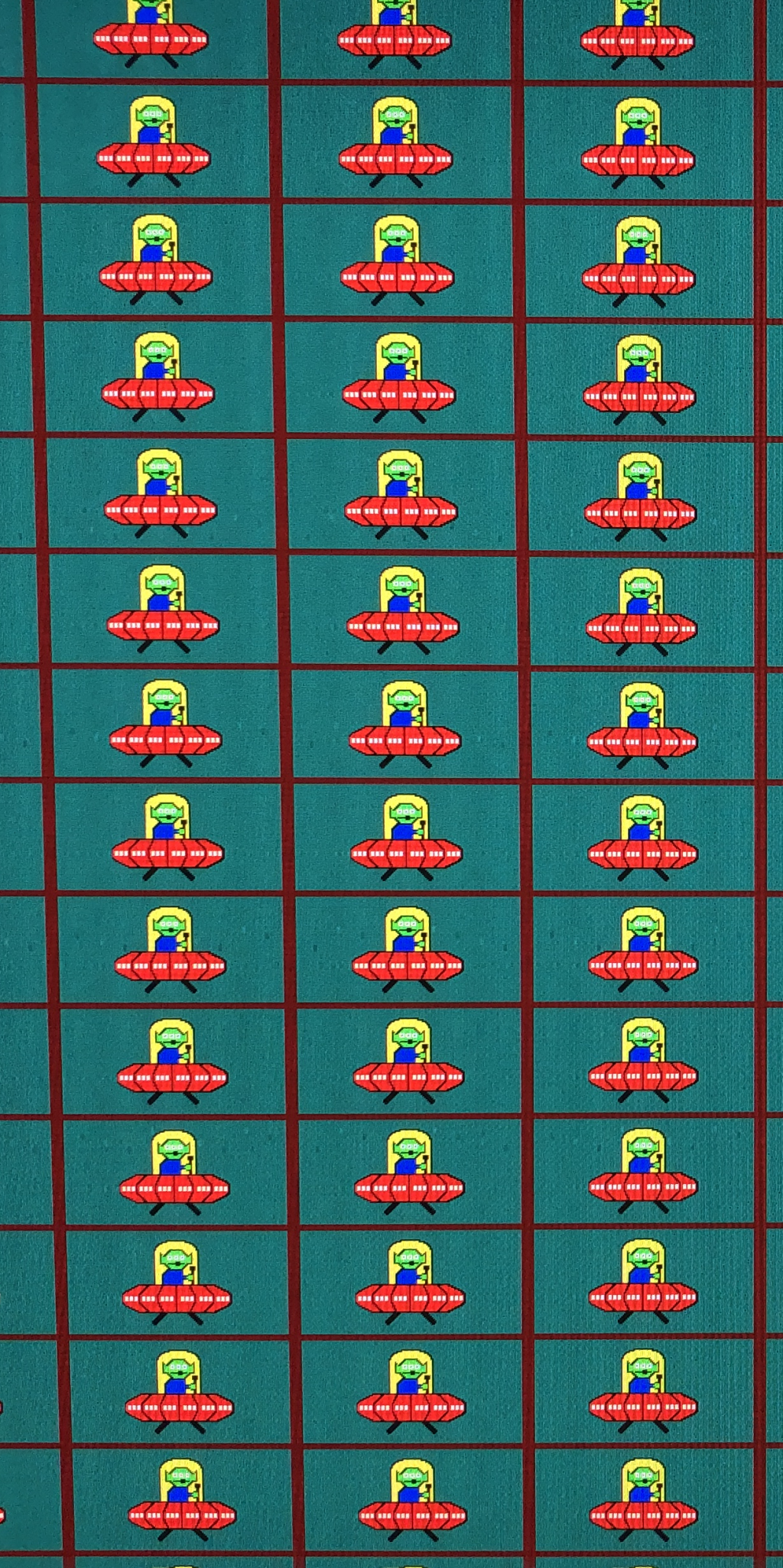

I took a few stationary shots at 1/240 shutter speed for pure xp normal, extreme, and ultra. I still don't quite understand how/why shutter artifacts occur, or how to mitigate them. I took three of each (except for normal, which I took another 3 after decreasing ISO) which you can find here. let me know if there's something simple I'm missing which would result in cleaner shots.
Oh, that doesn't look good. I don't recommend taking stationary images. But for those who know how to look, something can still be visible out of these.
I believe these should be representable, but correct me if I'm wrong:
Normal
IMG_1834 column 4 5 7
IMG_1839 column 6 7
Extreme
IMG_1831 column 6 7 8
IMG_1832 column 1 2 3 4 5 6 8
I agree, there's a lot of noise in those stationary shots. the 60hz and 120hz stationary images were much cleaner, but thinking about it more I believe I realize why: there's always going to be a slight mismatch between scan out and shutter speed (even when set to the same nominal value), but lower refresh rates (especially QFT tweaked ones) reduces the likelihood of capturing a frame mid-scan.
I'm happy to try some hand pursuits, but in the absence of a sync track how will I be confident that my pursuit speed matches and my final image is WYSIWYG? should I still use 4x shutter speed (so 1/60 for 240hz) or something else?
