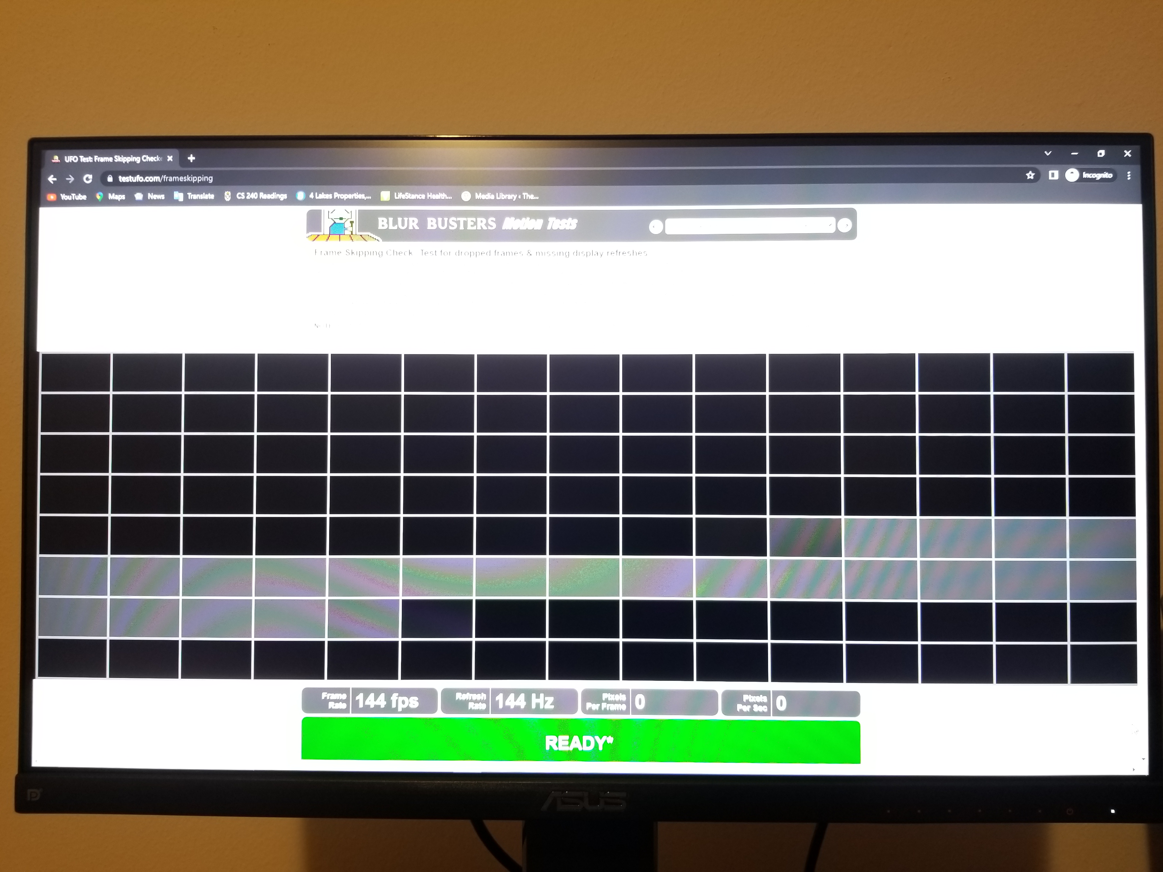

Thanks. I did go ahead to test my monitor just in case and I believe there are no skipped frames. What do you think? I attached a picture for your reference.
Also, just to clarify, frame skipping outside of the realm of monitor overclocking is only caused by a firmware bug, correct?

And yes, your monitor is fine at 144 Hz!
