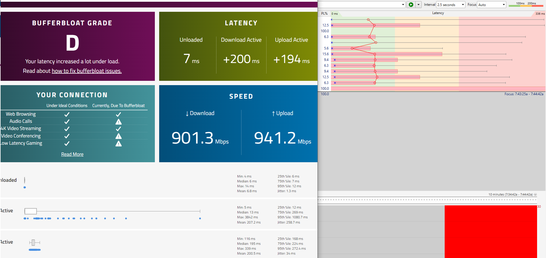

I've tested my connection at dslreports before and had A scores, but this test looks different, and I'm receiving D under gigabit and switched over to 100mbps on my network card and it dropped to F quality. Even dropping transmit/receive buffers to 128 from 1024 doesn't seem to help. [Edit: Also tried lowering MTU all the way to 1250.] This definitely matches my experience of feeling several hundred ms of lag on the upload side.... guess it's time to change ISP.
I find it strange for the CS2 console to show a solid connection with only a few packets jumping over 300ms, considering this shows a constant problem. [EDIT: I think this is due to using websockets, which is what the DSLReports site uses for testing. This does not mean you can simply trust the DSLReports test though because there is still TCP traffic happening during the game.]
I just verified while running the test and pingplotter UDP packets to 9.9.9.9, the pings were spiking along with the bufferbloat.
The ping spikes during increased upload events would also explain why the game seems mostly lag-free except when needing to do an action that affects server-sided objects.

I ran some more tests... android device over wifi hitting 200-300mbit has a B rating.
I had one of the recommended devices (eero 6) to mitigate bufferbloat and connected it and tested...
Normal settings still tons of bufferbloat with score of C, turning on SQM does change the bufferbloat score to A+.
I played a few games of Rocket League and was able to hit really crisp accurate shots, but there does still seem to be some desync where the ball will be hit by cars that don't actually touch it. Overall it's much better because the inputs aren't being delayed by a constantly fluctuating 200-400ms.

It looks like mitigation can be achieved through this command:
netsh int tcp set global autotuninglevel=disabled
I just verified changing this setting and turning off SQM... throughput is about the same reduction of 10% as SQM, and I don't have to use the eero.
viewtopic.php?t=11976
Here are some UDP ping test results while running the bufferbloat test:
SQM Only means autotuninglevel=normal with SQM on.
Windows Only means autotuninglevel=disabled with SQM off.
Here is the result with no SQM and autotuninglevel=normal:
