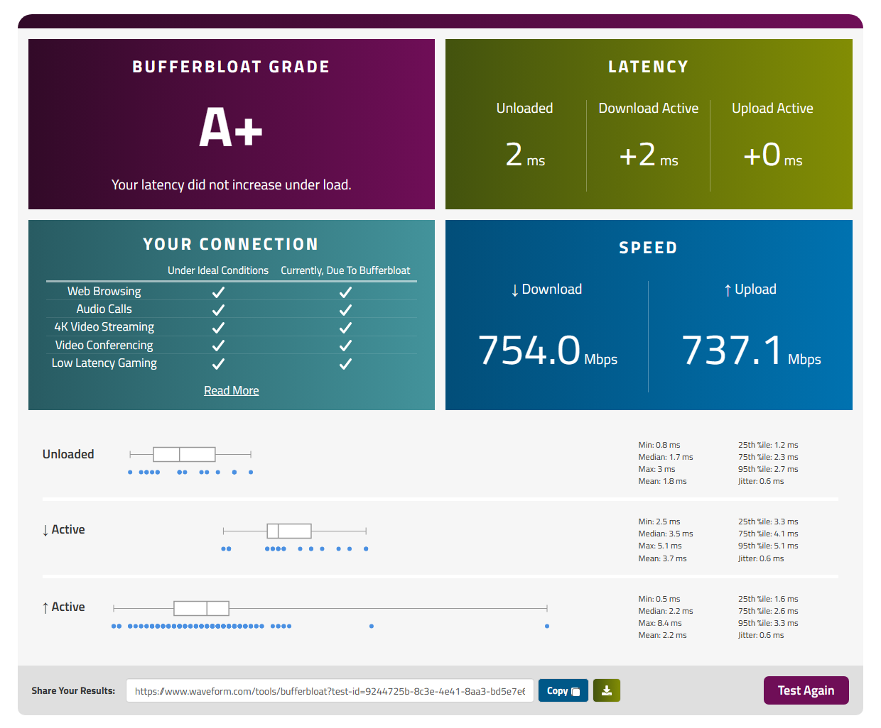

If your router have a good pipe/queue management and well set up, it should do the job like mine: https://www.waveform.com/tools/bufferbl ... 5e7e6b1204
2023-09-25 09_37_47-Bufferbloat and Internet Speed Test - Waveform and 1 more page - Personal - Micr.png
2023-09-25 09_37_47-Bufferbloat and Internet Speed Test - Waveform and 1 more page - Personal - Micr.png (430.99 KiB) Viewed 10927 times

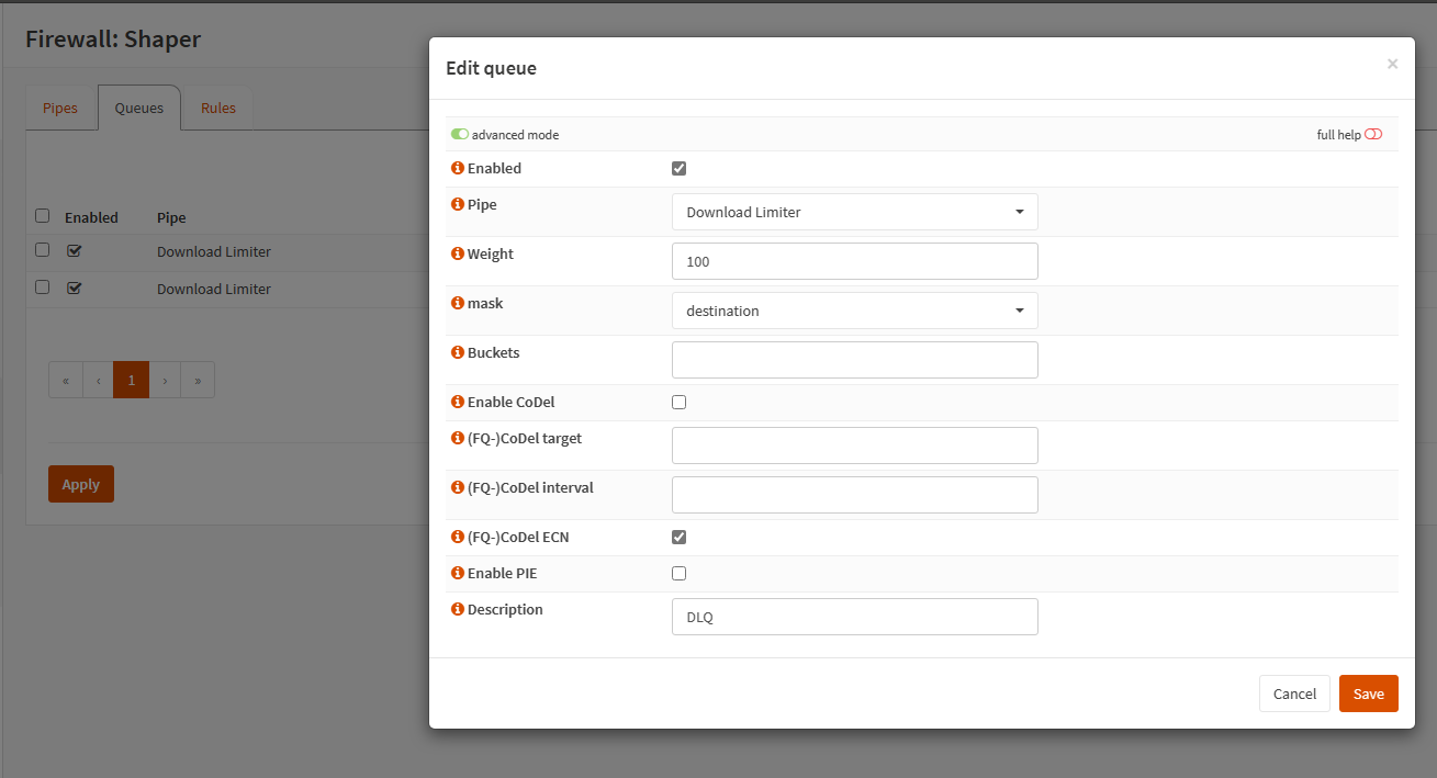

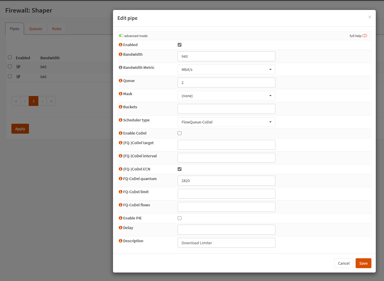

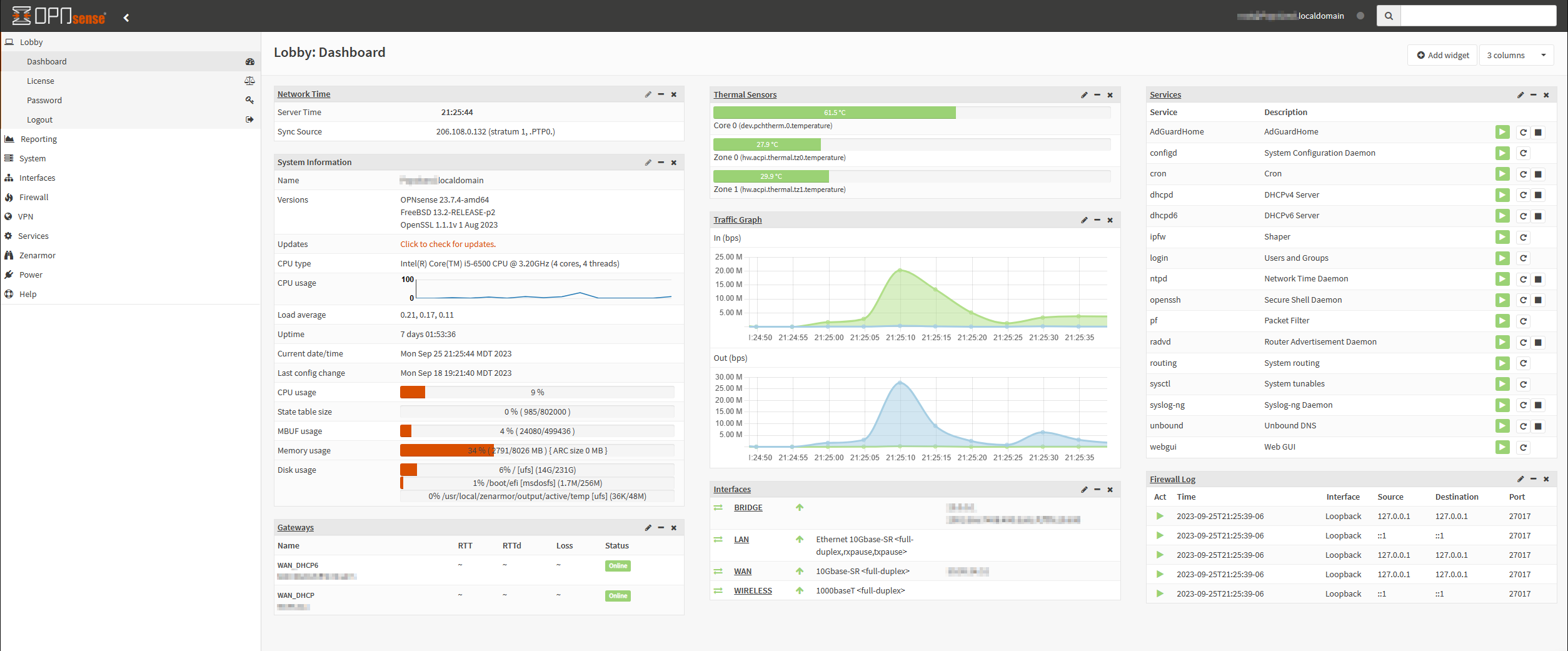

I do not use my ISP router or retail-grade router. I do use a small-factor desktop, nothing expensive that has at least the following:
- Intel CPU
- 4Gb Ram
- HDD or SSD with 32GB minimum
- VGA output (HDMI, DVI, anything)
- 2 Ethernets port (minimum)
Then you install a free Firewall that will act like a router on the small PC, I do use OPNSENSE.
How To Install OPNSENSE
Once installed you will have a dashboard like any traditional router but with more features:
Then you can manage your upload and download pipe/queue/rule to avoid bufferbloat
My configuration is: ISP > FIBRE > SFP GPON > SMALL COMPUTER (OPENSENE) 1 NIC to receive the SFP GPON connection and 1 NIC to plug the Network Switch in
Standard configuraiton is: ISP > DSL/CABLE/FIBRE > ISP MODEM/ROUTER (set to bridge mode) > SMALL COMPUTER (OPNSENSE)...
It's not too complex to install and has lots of documentation and tutorials online. I have 940Mbps up and down fiber but my friend has 50Mbps up and down and this thing is managing his bandwidth pretty well since he has other people using the same connection in his home for other usage while he is playing: https://www.waveform.com/tools/bufferbl ... f4d0c5d607
