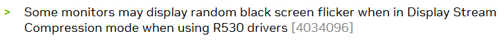

1. Displays in DSC mode can introduce multi-monitor issues due to bandwidth limitations, etc.
2. Random black screen flicker is currently a known Nvidia driver issue:
https://us.download.nvidia.com/Windows/ ... -notes.pdf
Whether the above is contributing to your particular issues on your specific model is the question.
Have you tried setting the PG27AQDM to 240Hz 2560x1440 8-bit to rule out DSC? Because that should prevent DSC from kicking in. You can also check to see if your monitor OSD has an option to disable DSC.
8 bpc mode was normal without any issues. So, I was thinking about that driver glitch too.
Is this a model-specific issue or is it a general issue when DSC is enabled?
Yes, I'm speculating on this part. Because there is no problem in 8bpc mode.
It’s just that it specifically states a black screen instead of an error like the one in the video, so I’m not sure.

Likely just a general description of DSC issues on the latest Nvidia drivers.
If you want to rule the driver out, you can temporarily download and install a version from before the issue existed (I don't know that version off-hand).
(jorimt: /jor-uhm-tee/)
Then I guess I'll just wait for the driver to fix this.
