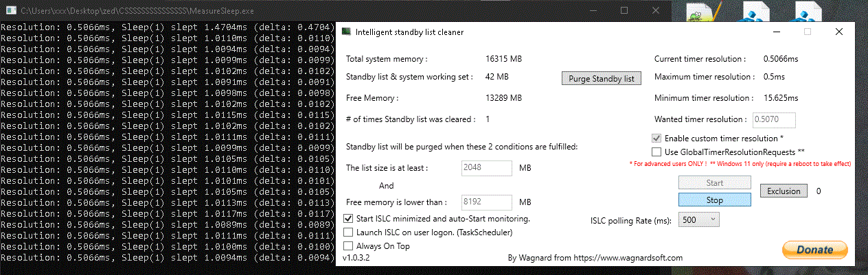

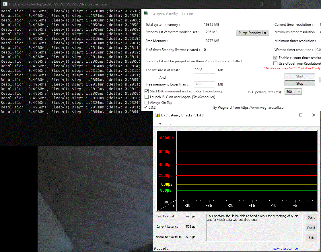

Hi can someone tell me what value should i put in "Intelligent standby list cleaner" (ISLC) so i am using windows 10 22H2 19045,as you see in screenshot below my "Wanted timer resolution" is set to 0,but when i do the trick from this video https://youtu.be/4VknzAMjPxE?t=484
everything changes.Also i forgot to mention i have Asus mb and i have HPET off,also keep in mind that like the guy from the video said if you have windows 10 you have to have islc running and "dpclat.exe".If you dont run it both,it will not work, also is this placebo or it works :?:
1709, 1803 latest w10 with good working timer and qpc based on base cpu freq.
yes, you need always open dpc.lat.cheker for correctly working any timer resolution on w10.
you just need find best value for your setup.

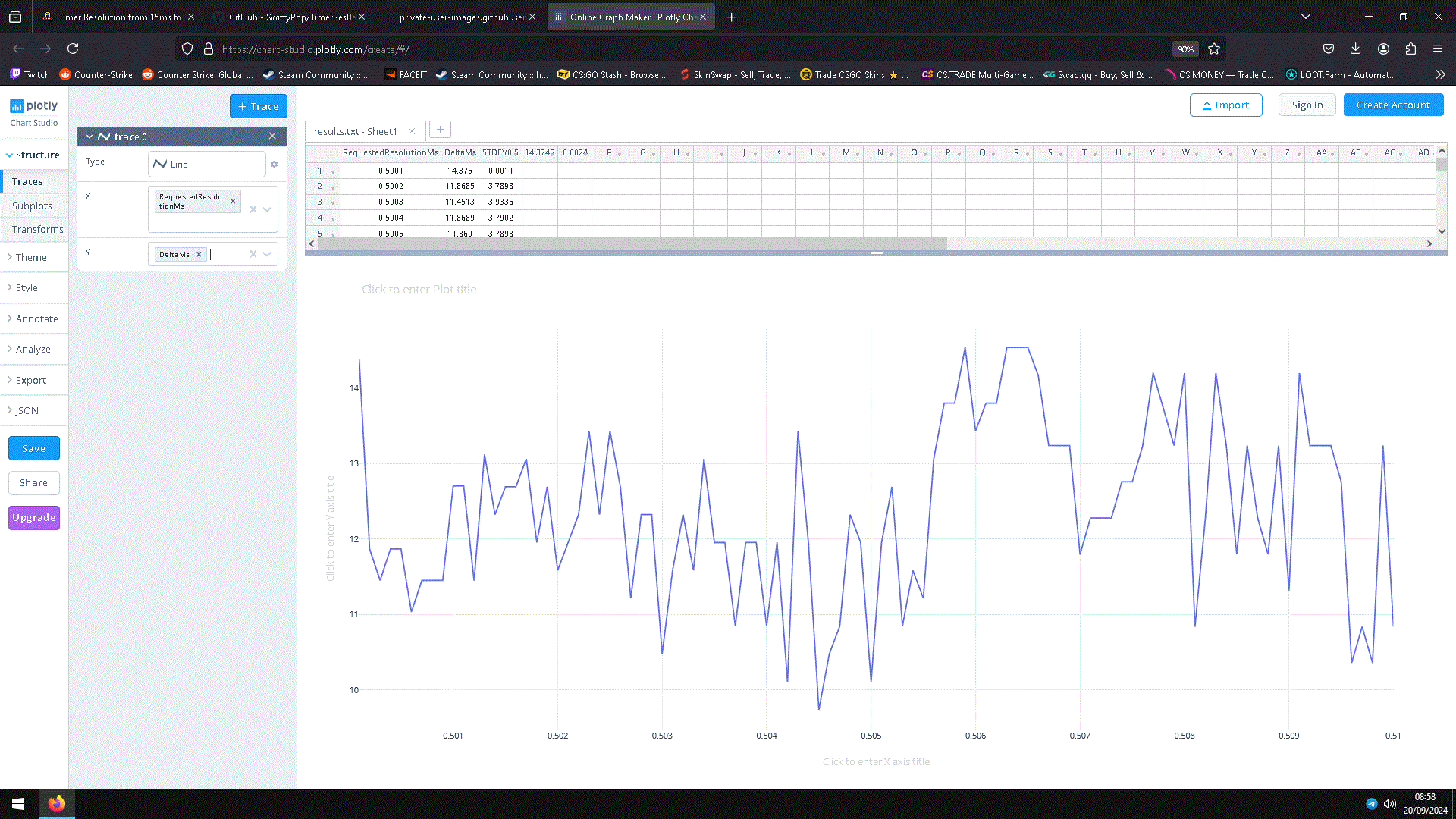

Thnanks man.I will try it right now.This is the graph from my result,my graph does not look like the guy from the github,and i did what he show i disable idle and then do the test but i did not understand wich one is the lowest?Should i do the test again but this i should leave open "dpclat.exe"?

This works only on windows 11, I'm also testing this and upgrading right now.
The benchmark works tho, I had 15ms sleep variance on win10.
I may be done for real with the input lag this time
In your case disable HPET and power saving in windows-
HPET:
bcdedit /deletevalue useplatformclock
POWER PLAN:
https://www.mediafire.com/file/39yxlxpb ... n.pow/file
in cmd: powercfg -import C:\PATH\TO\MUREN.POW

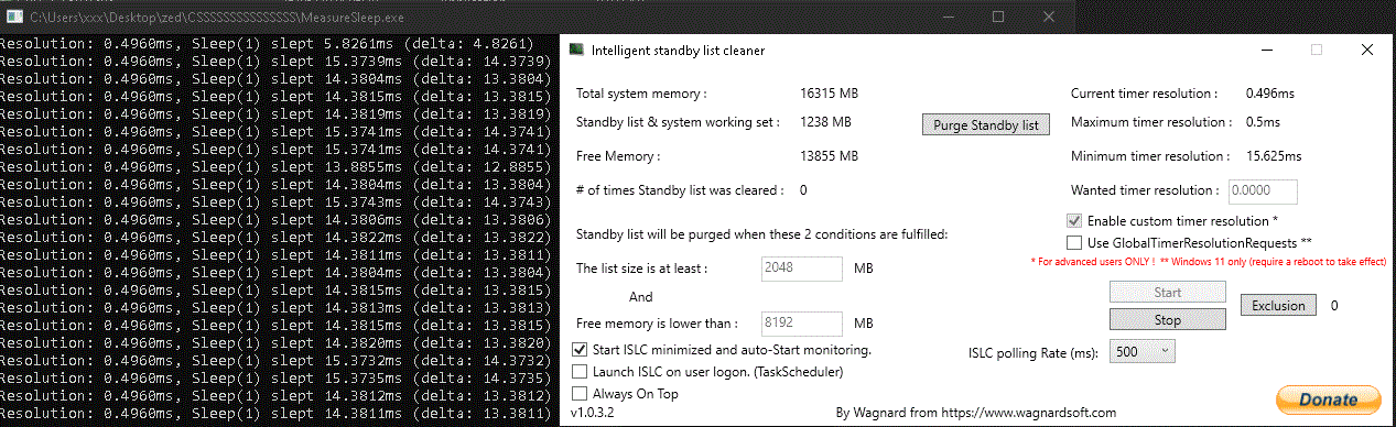

i disable hpet in bios asus mb it was hidden i use scewin and i uninstall it device manager,i dont have any bcedit and with "bcdedit /set disabledynamictick yes" it gets worse.this power plan has only idle disabled i think,about idle disabled i heard its bad,i have script for enable idle and disable idle before going in game.
