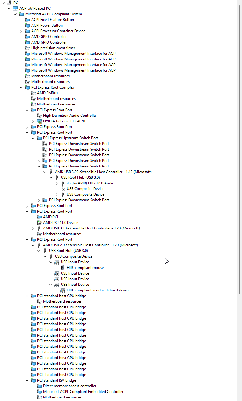

Can you check pm? Really interested in if you don't feel the stutters or if I've somehow missed something. I was running windows 10 for a long time but since switching to Windows 11 thinking the new mouse hid driver for high polling rate would be the last piece of the puzzle but alas I feel like it's still stuttering.
I've got 15 000h+ on cs and my cs2 is running incredibly well, and I don't think you configure anything that I don't including registry keys (unless you use something that is not on your github files- repo?).
24h2
Tried on both razer viper v2 pro & LGG LA-1
usb controller on core 9 (only cores 1-5 are handling cs2)
Direct cpu usb 2.0 controller (not going via chipset)
Avg fps on d2 map = 830 fps , 1% = 300 fps
Stripped windows with 0 bloat or unnecessary services etc
PG27AQN 360hz
