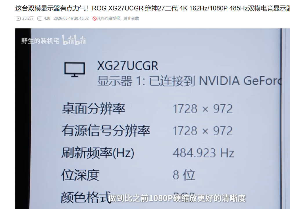

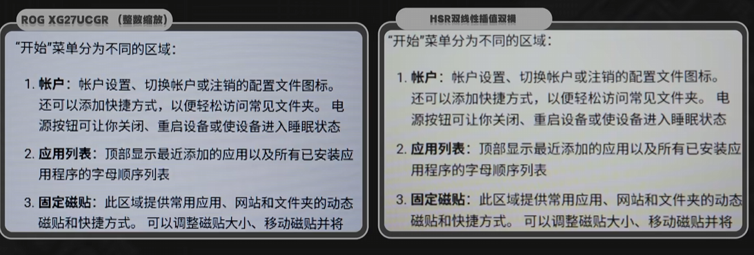

its not 24.5 inch 1080p its 1728x972 24.5 inch, but even 27 inch mode is 1:1
https://www.bilibili.com/video/BV1HjwEz ... 21a216589e
Screenshot 2026-06-25 060624.png (489.85 KiB) Viewed 1521 times
Screenshot 2026-06-25 060519.png (544.73 KiB) Viewed 1521 times
