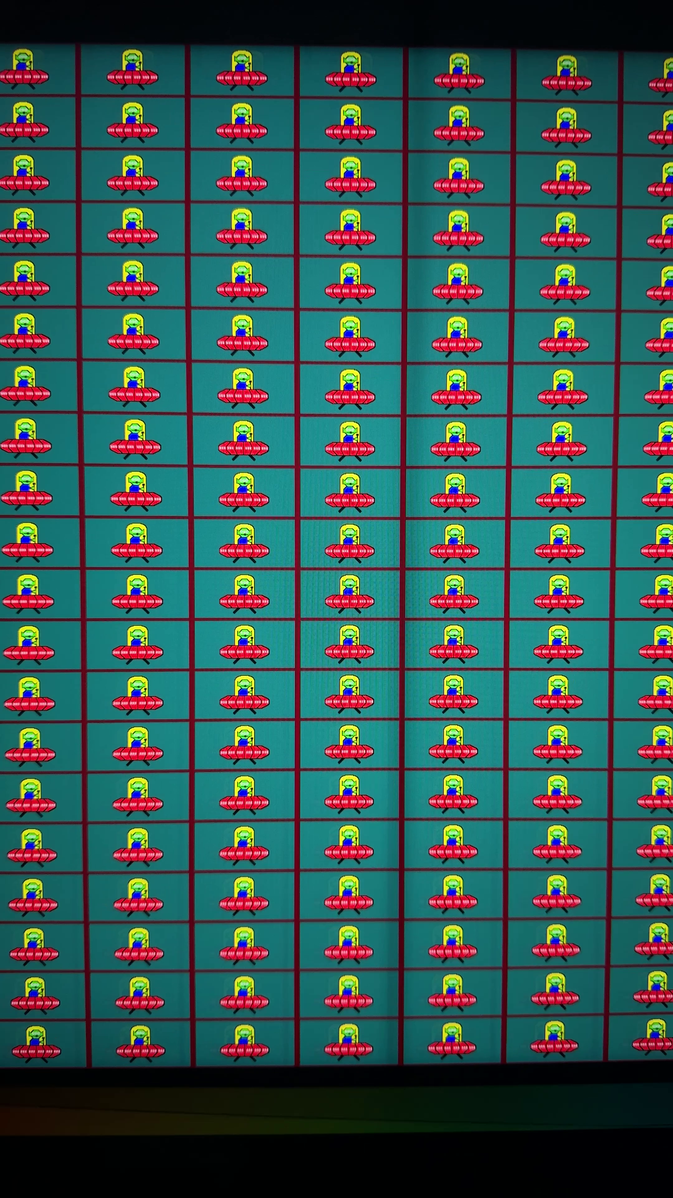

Post by edgintheledge » 03 Jul 2026, 05:35
I took a stab at a 1920px/sec 120hz crosstalk test as well. (30fps video @ 1/30sec as usual)
Do note that the slightly dark vertical band near the center is due to the phone's rolling shutter
(shot vertically so shutter sweeps horizontally across the screen and presumably caused the vertical band). I tried to capture as much detail, but you'd really need a camera on a rail capturing photos rather than video that compresses tiny details alot more, but this should give an idea of how much I was nitpicking every last detail when it's basically a nonissue in real use.

Post by brownvim » 03 Jul 2026, 06:04
edgintheledge wrote: ↑
03 Jul 2026, 05:35
Yeah in game its hard to spot even when looking for it, non issue.
It's a joy to play games at this clarity.

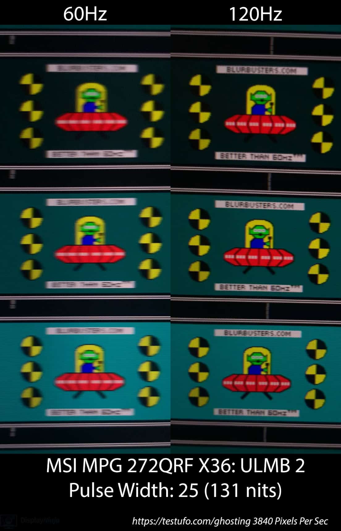

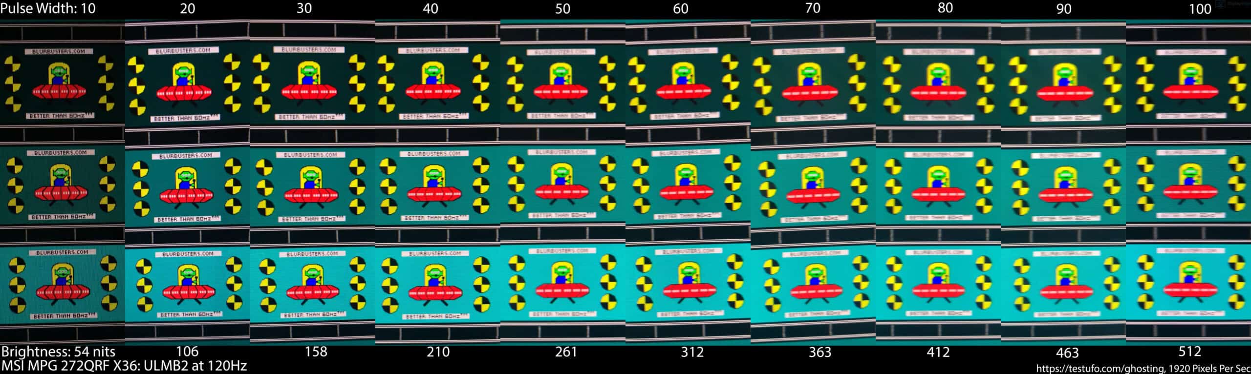

kyube wrote: ↑
02 Jul 2026, 12:35
Could you test the same PW's in intermediary speeds up till 3840px/s?
Displayninja done a good review with great pursuit shots here: https://www.displayninja.com/msi-mpg-272qrf-x36-review/
A pursuit shot here at 3840 px/s for 60hz and 120hz:
https://www.displayninja.com/wp-content ... 40-PPS.jpg
120hz at full pulse width range at 1920 px/s:
https://www.displayninja.com/wp-content ... scaled.jpg

edgintheledge
Posts: 49
Joined: 03 Feb 2026, 02:11
Post by edgintheledge » 03 Jul 2026, 07:32
Discorz wrote: ↑
03 Jul 2026, 06:54
That will do. Brownvim used PW 100, what did u use?
I used PW10

Post by kyube » 03 Jul 2026, 08:55
brownvim wrote: ↑
03 Jul 2026, 06:53
--snip--
Absurdly good implementation.
Finally, this is what I was waiting for since the annoucement of this monitor.
This is one of the best 120 Hz backlight strobing experiences ever released.
The only other competitors, which are QD or YAG-based (I discount KSF/PFS completely due to red image artifacts, such as the PG27AQN), have either had:
• Very noticable crosstalk due to slow G2G RT's of LCD,
• A bad pulse on / brightness curve due to insufficient voltage boosting (24-27" QHD ULMB1) and vendors always opting for a "brightness-first" approach
• Inferior total image quality due to LCD subtype choice (Zowie 24" FHD TN's)
This implementation eradicates all 3 concerns at once.
The 1440p/4K space lacked good implementations for years now. This even exceeds models in the FHD native image resolution category category.
The Viewsonic XG2431 is rendered completely irrelevant by this ULMB2 mode in terms of brightness & effective motion clarity capabilities.
A shame that they won't allow the end-user to use custom refresh rates (e.g.: 72,96,125,144, 250 & others) and allow ULMB2 to be used on 240 & 360 Hz.
Lack of HDMI 2.1 FRL6 is a bummer, but this eye-tracked motion clarity is definitely praiseworthy.
It looks ~2px of blur to me (maybe even between 1-1,5px of blur), which would imply a ≤6,25% pulse width on the setting that DisplayNinja tested.
This would make sense, as the voltage boosting is ~1800-2000cd/m2 and DisplayNinja measured ~130cd/m2 using the PW=25 setting.
It seems that PW<25 is the CRT-like eye-tracked motion clarity region for ULMB2 on these models.
Bravo Nvidia!
ps: I somewhat think they'd never release this mode if I wasn't bickering about it on here =p
