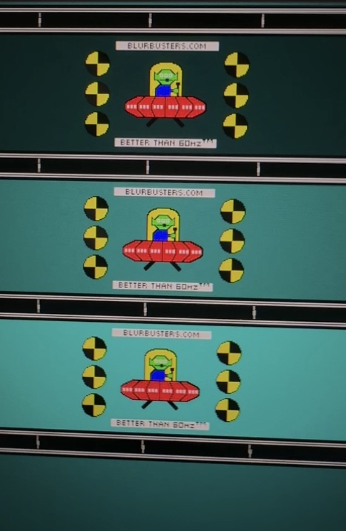

FW 1.1.10 Pulsar Pursuits
Took some smoothfrog shots with the Rtings pattern. It's much easier for me to tell when I got a good pursuit photo on lowest PW ULMB shots since the motion clarity is so good you can see the individual pixels. With the higher persistence for pulsar, it's a little harder for me to know if it's just persistence blur or my phone's focus being off, but the MPRT indicator seems about right in the photos. Some photos I wasn't sure which one is best so some framerates will have multiple photos if you want to pixel peep.
IIRC pulsar improvements were >200fps. 120 should be the same but I took another for good measure
120fps 1/30sec shutter, 16px/f = 1920px/sec
200fps 1/50sec shutter, 10px/f = 2000px/sec
