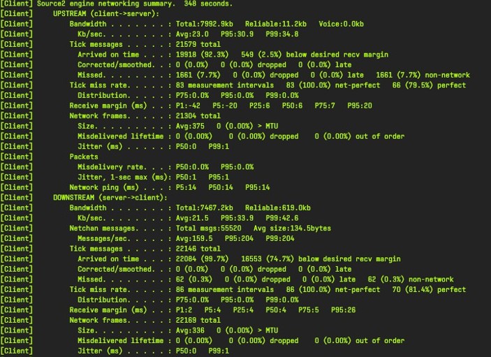

So here are my margins:
fresh installed win25h2 Pro no tweaks
9800x3d
MSI X870E Tomahawk
Lexar 6000mhz cl26 32GB DDR
MSI 4070ti
Intel T210 NIC
1300W Titanium Pro from BenQ
Aorus 360hz OLED in 24,5'' mode
Wooting 80HE
EGG OP8Kv2 2000hz 1600dpi
WD8100 SSD on PCIEX5
Cyberpower OLS1500EA-DE Double Conversion UPS (pc,monitor,router,vdsl,modem attached)
VDSL Line with 0 errors (I manually adjust the SNR and monitor the modem so I know there is no correction)
CMOS reset done and only EXPO default PBO was used and onboard NIC SOUND WIFI and BT were disabled.
since it's stock FSO,DVR,Game Mode,HAGS and all the defaults were enabled.
I am curious can you play a round on the xplay.gg retake servers, these seem to be the only servers where I can get a constantly low margin, but the servers are hosted where faceit also hosts their ESEA servers in Germany so since it's the same AS (BGP Network) I have the same exact peering and routing there but the xplay servers feel perfect but faceits don't.
I will now start to apply ReviOS and all my default tweaks install my vpn again and test some more tomorrow.

Re: CS2 Margin Graph
Posted: 08 Nov 2025, 21:52
by SammYrai
Depending what happens on the server (player joining many grenades and stuff) I saw this number rise above 20. But I can test either late tonight or tomorrow again. But I think you got it wrong, the second number after the build date should be the ping / rtt.
top->bottom explained is left->right in r_show_build_info
Build date - V = matchmaking S = dedicated (community) L = local loopback
Send buffer to catch up under jitter/loss frequently delayed inputs above 15
Average send + receive latency = Ping not reflecting spikes nor buffering
Receive buffer to catch up under jitter/loss frequently out-of-sync above 05
Downstream packet loss, clamped to 9.9% frequently missing sv refresh above 10
Upstream packet loss, clamped to 9.9% frequently skipping inputs above 10
Command queue starve (too many behind) : bloat (too many ahead) often CS2'd above 0:0
Render interpolation = tickrate = 64/s (15) higher if server has performance issues
Min frametime = Max fps (1000 / 04 = 250) no decimals so actually less
Max frametime = Min fps (1000 / 12 = 83) no decimals so actually less
taken from https://www.reddit.com/r/GlobalOffensiv ... t/n23umpl/

Can you tell me what's wrong here ?
My cs2 experience is very inconsistent with alot of out of order packets
