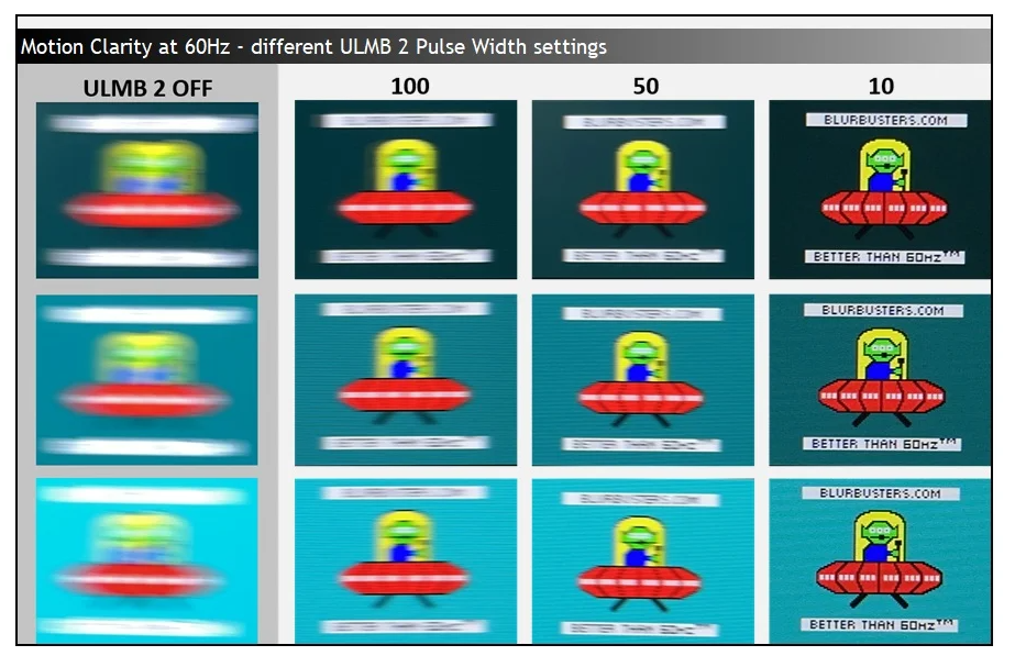

Kyube, from my own testing with the same TestUFO patterns:
At 60 Hz ULMB, dropping the pulse width below ~30 gives a very noticeable jump in clarity (exactly as TFTCentral showed). It shows clarity difference across the whole PW range.
At 120/240/360 Hz ULMB2, lowering the pulse width slider has almost no visible effect on clarity — it mostly just dims the screen.
It really feels like the higher refresh rate modes are still locked (or limited) around the same ~25% duty cycle that normal VRR Pulsar uses, while only the 60 Hz mode got the full adjustable treatment.

tft central
- Screenshot 2026-03-21 205719.png (574.07 KiB) Viewed 2828 times

To confirm we would need this test done at 120hz, 240 and 360hz modes. To my eyes the clarity stays the same across the whole pulse width range, or its a very subtle clarity change.

The new firmware has 60hz support and adjustable pulse width.RonsonPL wrote: ↑22 Mar 2026, 05:10True, but for some (for example for me) it's still unusable.

But I think the adjustable pulse width in the 120, 240 and 360 modes is broken.
