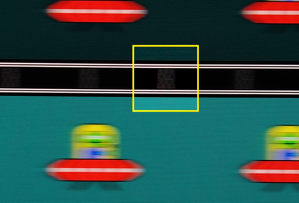

One person using XG2431 PureXP said he got eye strain within 2h and headache after 4-5h, while with XL2546X DyAc 2 he got no eye strain or headache within the 4h he tested. Interesting stuff! Simply rolling the edgelight (DyAc 2) instead of globally flashing it (DyAc 1) can help eye health or at least postpone the side effects. This could be because light hits the pupils less aggressively. Full black periods are still there the lower the frequency of DyAc 2, so its not like parts of the screen are allways illuminated. I assume he tested max Hz. But MBR is still flickering and this doesn't necessarily apply to everyone. If you continuously feel discomfort, then ofcourse don't use it. It's your body telling you something is wrong.
DyAc 2 vs DyAc 1/PureXP @120 Hz
Image Image
Animation source:
https://jisakuhibi.jp/review/zowie-xl2566x-plus#mbr-d2
https://jisakuhibi.jp/review/zowie-xl2546x#mbr-d2
https://jisakuhibi.jp/review/zowie-xl2586x#mbr-d2

Discorz wrote:
17 Feb 2025, 03:41
Image Image
Animation source:

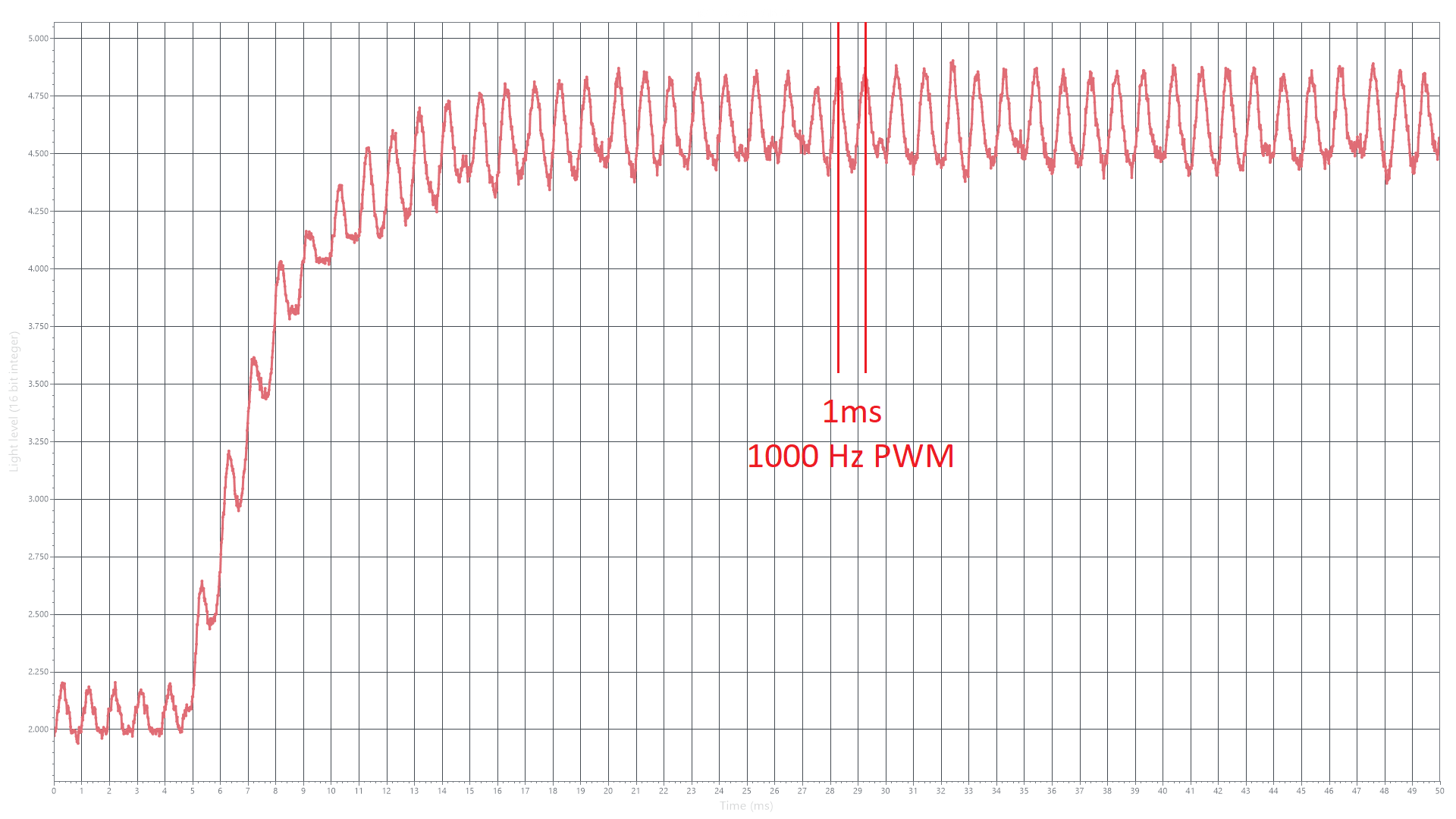

Yeah, many other, including me found XG2431 to be a bit eyestrainy with either PureXP on or off. Although it's using classic DC dimming I did spot some PWM-like behavior. But actually a completely different factor could be the cause. I ain't goin' that rabbit hole.
XG2431Run 1-RGB 0 to RGB 51_2.png (142.63 KiB) Viewed 9292 times
However, the sync track does not line up with 1000 Hz. I'm getting more like 4.7 ms = 210 Hz PWM. Not sure whats going on.
XG2431 pwm_dimming.jpg (284.39 KiB) Viewed 9292 times
