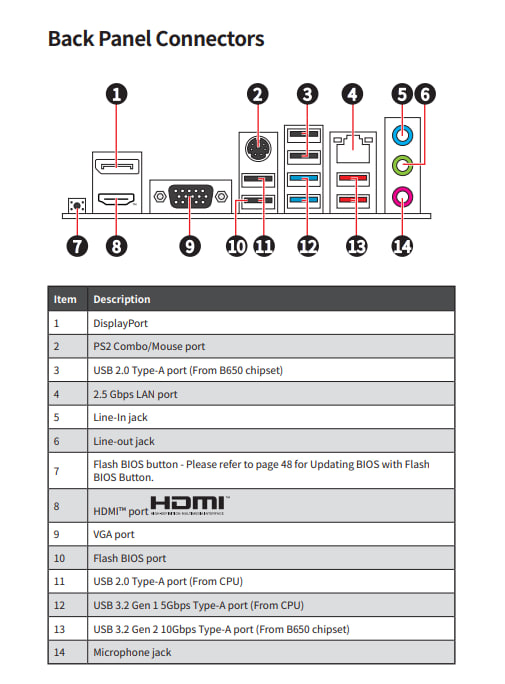

what usb ports are better to choose on msi pro b650 m-p? My mouse, keyboard and microphone have USB. and I don't know where it's better to insert them into my motherboard for less latency. please help me.

10 or 11 if you want it on the CPU's USB controller, or one of the ports labeled "3" if you want it on the chipset's controller.
Does it matter? I have never seen a difference. But I'm on a 1000Hz mouse. Maybe with higher polling rate mice it makes a difference, I don't know.
But anyway, also take a look at this:
viewtopic.php?f=10&t=7618

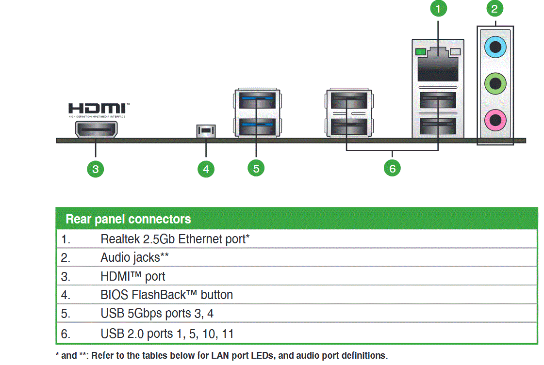

ok so can you tell me on my mb wich are the ones to the cpu please? https://www.asus.com/motherboards-compo ... e-b650m-r/

thanks for the answer, but why do you advise me to use usb labeled "3" and not 12?
Those are USB 3. You can try those as well, but I'm not aware of any benefits in using USB 2 devices on USB 3 ports.
No idea. It doesn't say. Maybe you can find out with HWinfo or some other tool.
