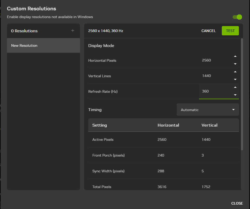

I put my monitor into 60hz first - then disabled DSC in the monitors OSD and made sure it was all using HDMI 2.1.
Then, went into Nvidia Control Panel (or NV App now!) and created a custom resolution, kept the resolution the same and just gradually bumped the refresh rate up. At 8 bit I could hit 360hz, at 10 bit the maximum I could hit was 320hz, although it gave me occasional issues so I found 300hz to be 'safer' for 10 bit.
8 bit at 360hz was no issue at all.

Hmm, what timing mode did you select? Having trouble getting anything past 300hz. But not sure if it is defaulting to 10-bit despite me having 8 bit on, not sure.
Just 'automatic' on the timing selection, what GPU do you have? I wonder if there's anything amiss with available display heads.
I'm on a 5070Ti - just checked again this morning to make sure I wasn't losing my marbles and I can definitely get 360hz at 8 bit with DSC switched off in the monitor OSD - and then 320hz at 10 bit also works when I press 'Test'.
