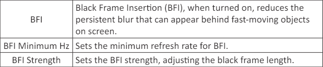

I don't think Blur Busters has anything to do with BFI feature on this model. Blur Busters Verified is certification for ideal sample-and-hold modes (240+ Hz with excellent refresh compliance). But who knows... it sure seems like Chief did some assistance because of the 60 Hz support and advanced "BFI Strength" option.
According to user manual Minimum Hz can be adjusted in 1 Hz increments between 48-120 Hz. So 60 Hz should work. Kudos to ViewSonic for that! I suppose it's single-strobe at least at 60 Hz, because of Blur Busters influence from before.
Investigating further:
120 Hz max reveals minimum achievable MPRT is equal to max Hz MPRT (1000/240 = 4.2 ms), which goes in line with current oled limitations. That's kinda fine if u need 60 Hz strobing, but meh for 120 Hz. 1 Hz incrementals also reveal it might supports custom resolutions.
BFI Strength is probably similar to pulse width, but it's not a percentage of refresh cycle like with classic bfi/strobe modes. Maybe something like:
100 = more blur reduction = less brightness = minimum MPRT (maybe fixed 4.2 ms)
50 = less blur reduction = more brightness = maximum MPRT (maybe 6.2 ms @120 Hz, 10.4 ms @60 Hz, 12.5 ms @48 Hz...)
All in all, MPRT is kinda crappy and brightness might be crappy as well. I personally wouldn't be too excited about this generation of bfi on oleds. It feels like strobing for the poor on expensive monitor unfortunately.
