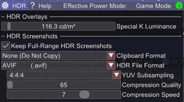

If you use SpecialK, you can take screenshots in AVIF format. Set it to quality 65 (ctrl+click on the slider to be able to enter that number.)
AVIF HDR screenshots are very small (like 1MB or so.)
Thanks, this is good to know, I do use Special K for FFXVI, alas while ingame I see the noise, in the screenshot I do not. Tried different compression and even saving JXR to no avail. The Tekken 8 JXR shows some but less prominent as well than ingame. Don't know why, perhaps just the photos application likely handles it differently than the game.
