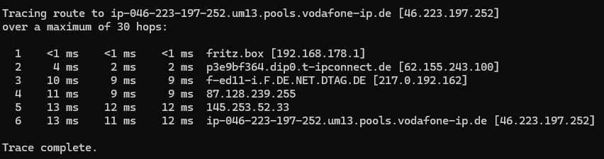

Make a tracert to the first node 46.223.197.252 show the result. It seems to me that the problem is between LaggyTyp and the first node. I doubt that you will have a jitter of 5ms like LaggyTyp.
This is a tracert of 2000 km 2 different providers at the same time.. And Vodafone, the intermediary that sells traffic to my country, does not cause any complaints.

1000WATT wrote: ↑
27 Jul 2025, 14:36
tracert
tracert
Screenshot 2025-07-27 215114.png (26.21 KiB) Viewed 3248 times
1000WATT wrote: ↑
27 Jul 2025, 14:36
tracert doesn't show jitter, a repeated ping test does. Here's my result
ping
ping
Screenshot 2025-07-27 215338.png (11.81 KiB) Viewed 3248 times
High jitter might just be a simple QoS mechanism where ICMP packets are deemed unimportant in a high-load scenario, thus being delayed on purpose for other, more important traffic to come through. It might indicate something, but it's not definitive.
