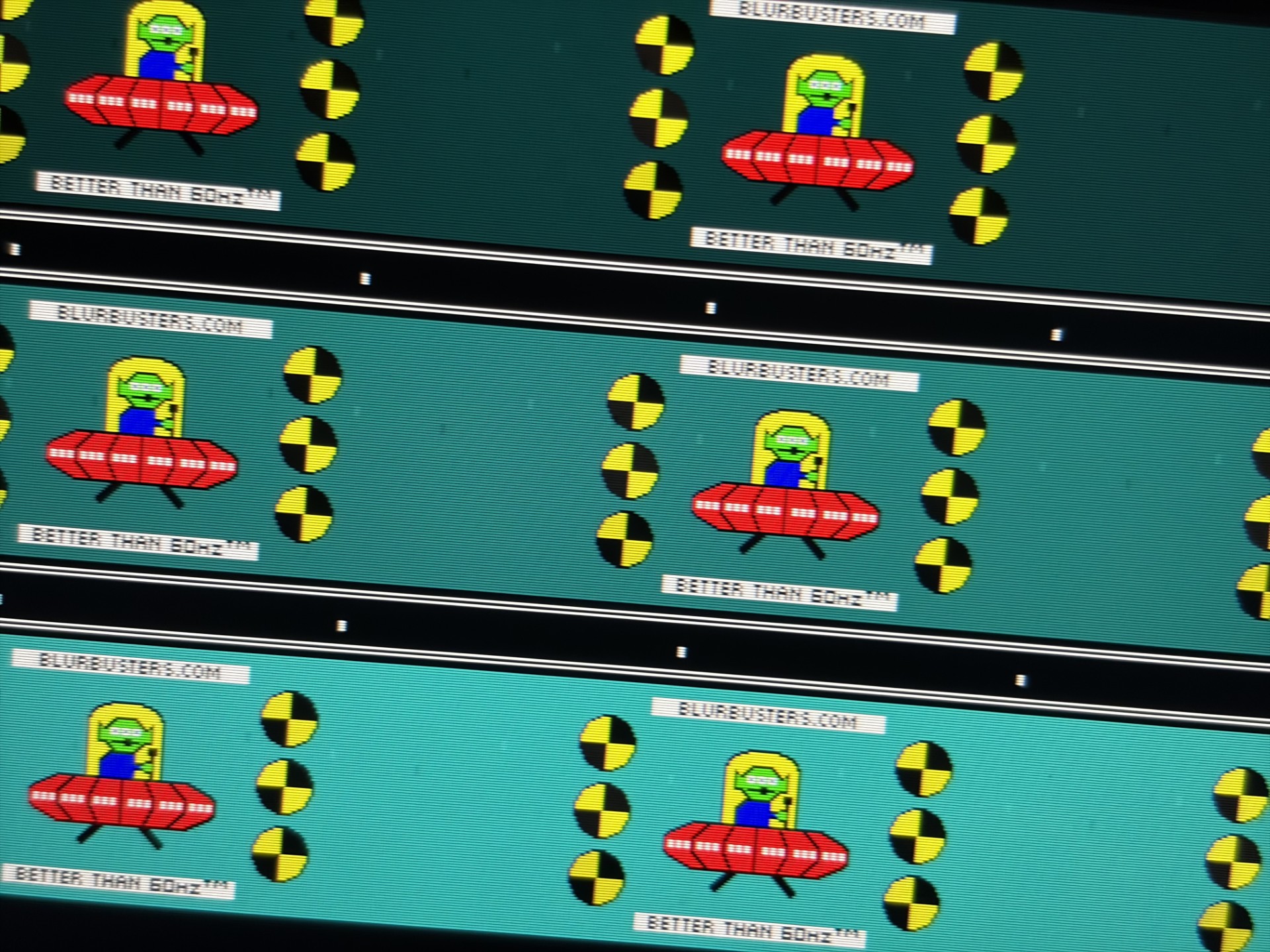

As you don't have a Pulsar, this is what I see at 18 PW at 60hz 100nits (1920 px/s):
I can try and get it synced up better and do the different pulse widths, regardless looks and plays great.
