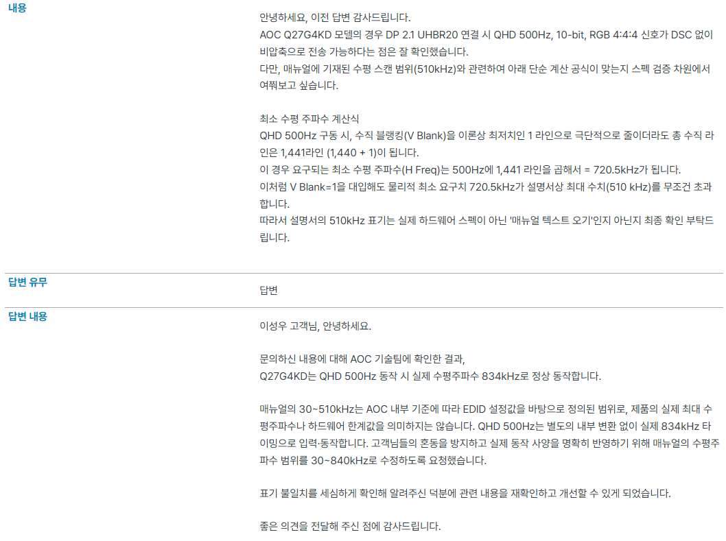

Got the official engineering response for Question 2 regarding the AOC Q27G4KD (QHD 500Hz)!
I attached the full screenshot of my Q&A thread with local AOC/Alphascan support (in Korean). Here is a quick translation/summary of what happened:
1. My Question:
I asked if the manual's 510 kHz limit was a typo, pointing out that even with a theoretical minimum V blank​ =1 line, QHD 500Hz mathematically requires a minimum scan rate of 720.5 kHz (1441 lines×500 Hz).
2. AOC Technical Team's Response:
  • Actual Operating Frequency: Confirmed that the Q27G4KD actually operates at 834 kHz at QHD 500Hz (V blank =228 lines, utilizing ~85.4% of DP 2.1 UHBR20 effective bandwidth).
    Native Uncompressed Input: Confirmed that QHD 500Hz inputs and operates at native 834 kHz timing without any internal conversion or DSC.
    Manual Revision Requested: Confirmed the 30~510 kHz in the manual was an internal EDID definition mistake and **officially requested HQ to update the manual's horizontal scan range to 30~840 kHz** to reflect real hardware limits (840 kHz→V blank = 240 lines, utilizing ~86.0% bandwidth).
It’s really satisfying to see a global manual typo officially corrected through basic bandwidth math!
