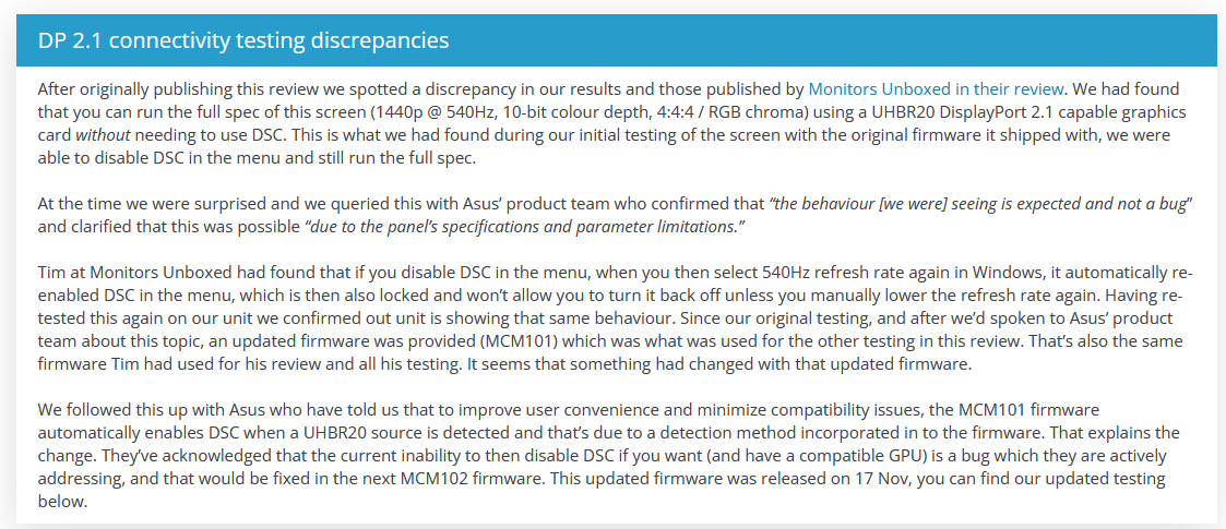

UPDATE (Partially Solved - Question 1-1)
Hey guys, just wanted to update this thread as I found some interesting info regarding my first question.
If you search Google for "TFT Central ASUS PG27AQWP-W review" and check the "DP 2.1 connectivity testing discrepancies" section, they actually confirm that running 1440p at 540Hz with 10-bit RGB 4:4:4 uncompressed (DSC OFF) works natively. Asus confirmed to them it is expected behavior due to tight panel parameters (low V-blank). Also, the bug in MCM101 firmware that auto-enabled DSC was officially patched in the MCM102 firmware released on Nov 17. So manual DSC-OFF at 540Hz is now fully working on DP 2.1.
