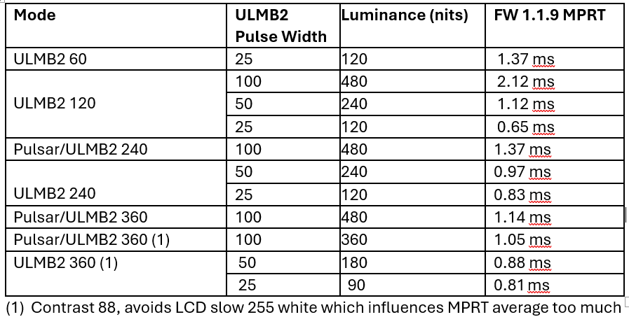

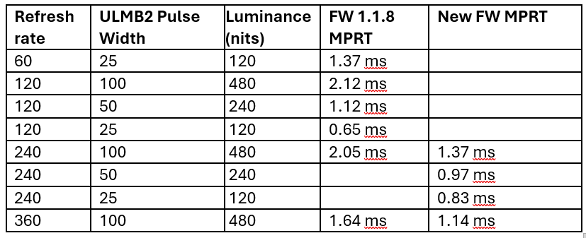

With the latest 1.1.10 update, is Pulsar@240FPS the same as ULMB2 PW=100 240Hz in terms of MPRT?
Edit: Given those two tables from drG-SYNC on the NVIDIA forum, it seems like yes:
That would be pretty neat, to have an easier time with no tearing. I didn’t get Scanline Sync (Special-K or RTSS) to work properly, but I really don’t want to have neither tearing nor the high V-Sync input lag.
I will likely use ULMB2 @ 60Hz, 120Hz and Pulsar for everything around >200 FPS, as a fully stable 240 FPS for ULMB2 240Hz is rather hard to achieve.
