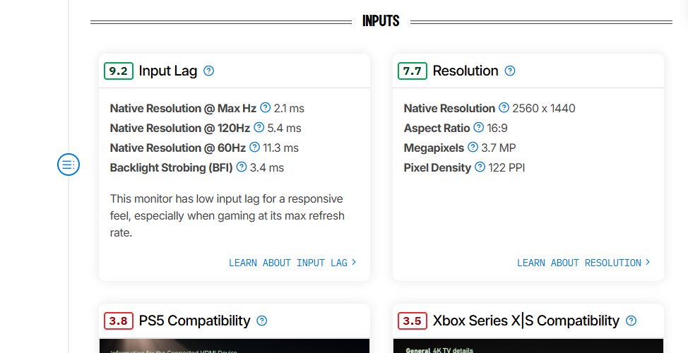

Post by MSIfanboy » 26 Sep 2026, 19:16
Ziehesh wrote: ↑
21 Sep 2026, 14:58
Who have rtings account,can a give screenshot with input lag on this monitor please ?
vs pg27aqn
Screenshot 2026-09-27 101136.png (78.45 KiB) Viewed 1064 times
