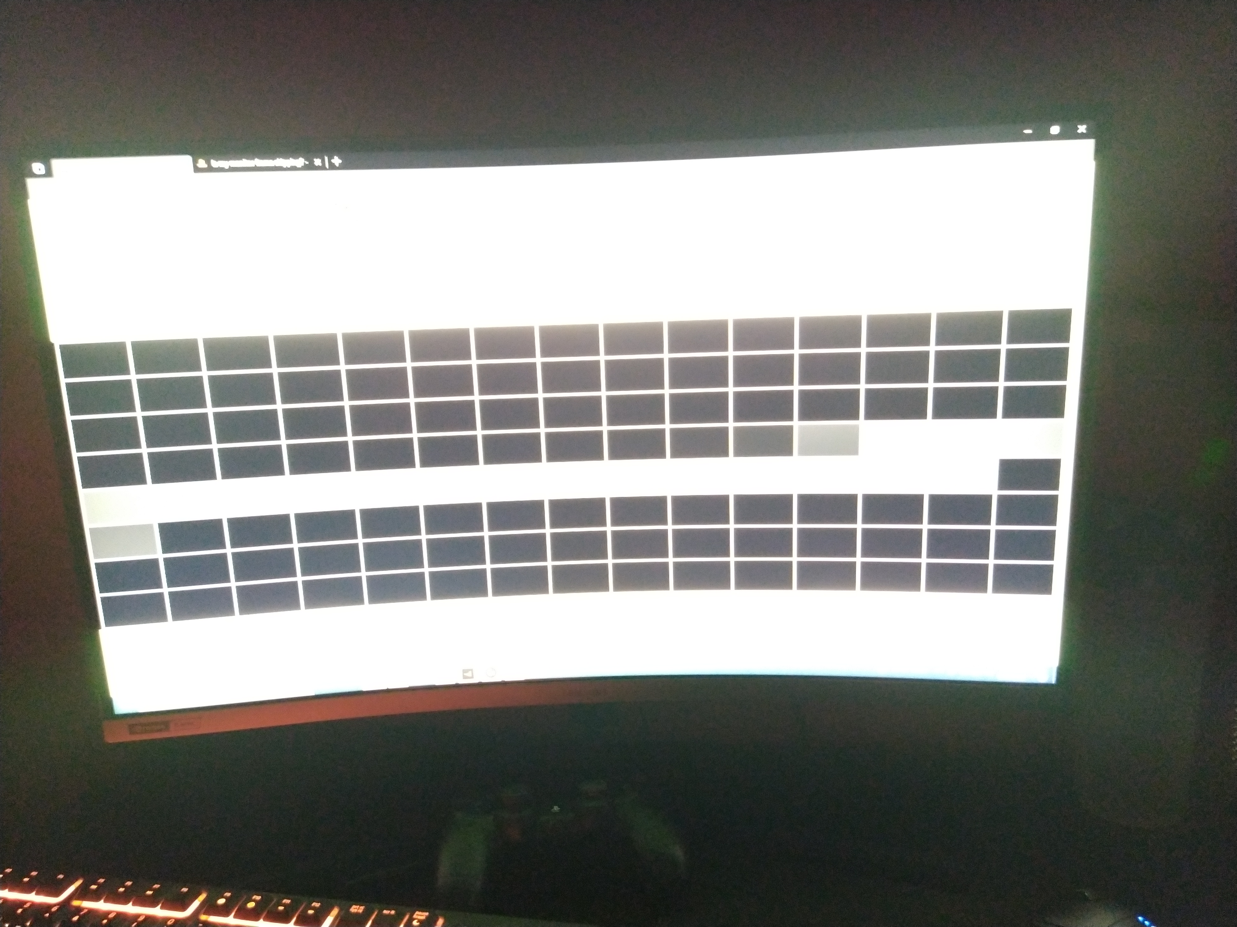

tev
Joined: 29 Jun 2021, 01:41
Re: Is my monitor frame skipping?
Post by tev » 29 Jun 2021, 02:14
Here is the best picture that I could get

Post by RealNC » 29 Jun 2021, 05:42
tev wrote: ↑
29 Jun 2021, 02:14
That looks like frame skipping to me. The second to last box is black.

Post by Chief Blur Buster » 30 Jun 2021, 00:47
RealNC wrote: ↑
29 Jun 2021, 05:42
tev wrote: ↑
29 Jun 2021, 02:14
It might be -- but...
One frame got skipped but the photo is a little too overexposed to show if it's a READY (green) or a browser dropped frame.
Would it be possible to use a different camera (e.g. iPad or Android or iPhone), and/or to dim the monitor brightness even further and/or download a 3rd party camera app that lets you use a very low ISO value (e.g. ISO 80)?
