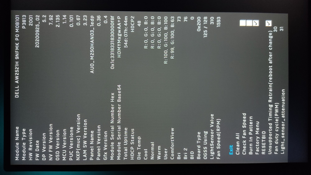

Oh sorry you just hold 1 + 3 and then press the power button, don't release them, and once it turns on the service menu is on the left side, sometimes it vanishes instantly but do it a couple times and it will appear for sure. Can you take a screenshot of both all of your service menus? I'd like to compare versions. Thanks!

I cannot seem to enter mine, what's considered 1/3 buttons? tried both combinations from up and down.

  1. Power off the monitor.
  2. While holding buttons 1 and 3, press power button once to power on the monitor, keep holding 1 and 3 until image with factory/service menu appears on screen. Sometimes menu disappears when buttons 1 and 3 are released. In this case repeat the process.
Not much in there tho. I'd like to see "disable boot logo" option to cut on boot time.

Figured it out, thank you. Though couldn't find the boot option? Wouldn't mind that off.
Here is mine:
