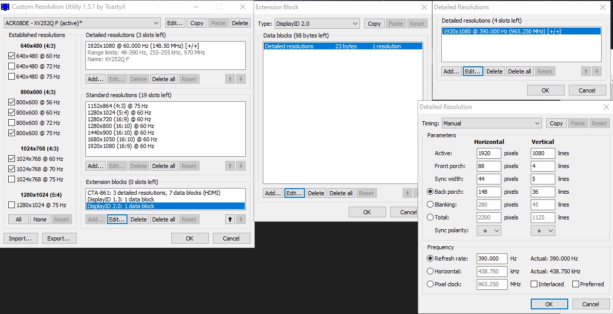

pasutazame
- Posts: 3
- Joined: 19 May 2021, 01:10
Additional Information:pasutazame wrote: ↑14 Oct 2022, 14:54I have had experience using rx580 with 390hz. It probably works without problems on older versions of the driver (before April or previously). For 6600xt I had to update the driver and 390hz was gone.
I was able to get 390hz on new AMD driver versions with CRU
Use it at your own risk
CRU -> Extencion blocks -> add -> Type displayID 2.0 -> add -> detailed res -> add -> refrashrate 390 -> ok, ok, ok, ok -> restart/restart64
- 390hz cru.jpg (169.31 KiB) Viewed 8809 times
