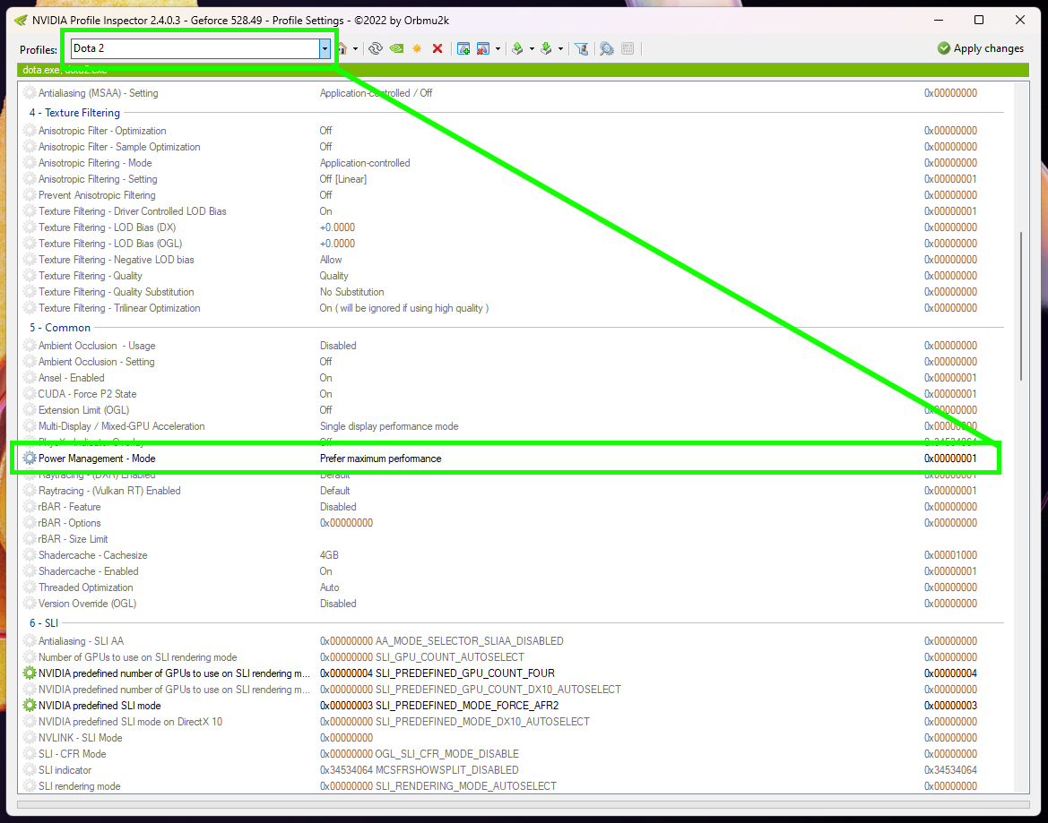

That's a faulty test; with framerates below the refresh rate, standalone V-SYNC will always stutter, regardless of the physical refresh rate, due to repeating a frame roughly every second, even without half refresh lock behavior.
What I assumed you were complaining about (and maybe still are) was that same behavior occurring even with G-SYNC on + V-SYNC on + framerates within the refresh rate, which isn't expected (assuming it isn't the system causing the stutter, which no syncing method can fix). That is, it's not expected for G-SYNC to act like standalone V-SYNC (when properly configured) in that scenario.
Look, you're mostly pointing out Dota, so I'll stick to that. I downloaded it last night and loaded up a replay to test as a makeshift benchmark. Even with all my settings configured properly, the in-game framerate limiter still was allowing/causing jitter/judder during panning.
Dota is a CPU-limited game. I.E. it barely uses the GPU on capable system, so I don't even know why a setting like Nvidia Reflex is included when the possibility of the GPU usage on a high end system maxing out is near 0.
Also, since the game will barely push the GPU on a 4070 Ti, it will downclock. To avoid that, and to ensure proper configuration for all other settings, try...
NVCP settings:
Nvidia Inspector settings:
(download here if you don't have it, you can also set this for the game profile in NVCP under Manage 3D Settings > Progam Settings tab, if you prefer)
RTSS settings:
(download MSI Afterburner here if you don't have it already)
Dota 2 settings:
(I used the Vulkan API, which you can download in the DLC section for the game, along with OpenGL, but use whatever API works best for you and make sure it is the one selected and applied below instead. Also, you'll have to restart the game for it to take effect).
I did the above, only at 1440p 240Hz with a 224 FPS RTSS limit, and I had no noticeable stutter when moving or panning the camera, with only minor expected frametime variances on an occasional basis.
If that still doesn't work for you, A) you're experiencing something no one else does on any other system (unlikely), B) you expect there to never be a single uneven frame EVER (most likely, but who knows), or C) Stonehenge (no one in the world can determine the true origin).
Again, your video captures are useless since they aren't 1:1 with your monitor framerate or refresh rate. If someone like me was able to see it in person, we'd be able to confirm whether what you're experiencing is abnormal. Obviously, that's not practical, so we do what we can and try to assume the people we are talking to aren't technological hypochondriacs.
