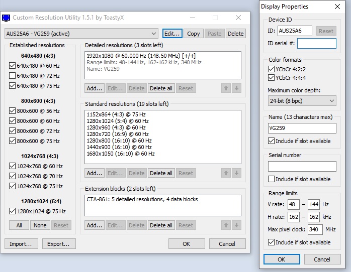

Check the VRR range in CRU. Sometimes LFC can interfere with sync smoothness. Use OSD fps counter to check if its syncing correctly.

Thanks for your interest.
What I obtain without modifying anything is this, I think it is correct since it indicates from 48 to 144 hz which are what the monitor has.
In the monitor I cannot find a counter in the OSD.
Greetings.

If your gpu is not fast enoguh could be just unstable frametimes, stutters, dropping bellow 48 minimum and messing with the sync. Maybe expanding the range to 30-144 will help. Its worth trying. Also test it in other less demanding games where your gpu can push higher fps. Smooth Frog is perfect for testing these things - just limit the frame rate with a simple slider.
