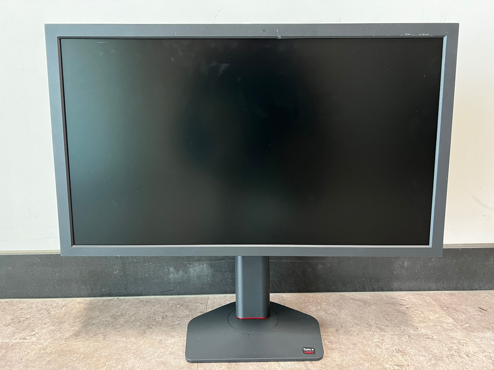

XL2566X+, 400HZ DYAC 2
https://www.reddit.com/r/Zowie/s/pB7l5v4QWR
ParkGGoki posted this on the Zowie reddit.
I found the original link: https://m.dcinside.com/board/mnt/742393

Nasty ugly bezels and TN panel 1080p YUCK

Looks like leaks were true again.
