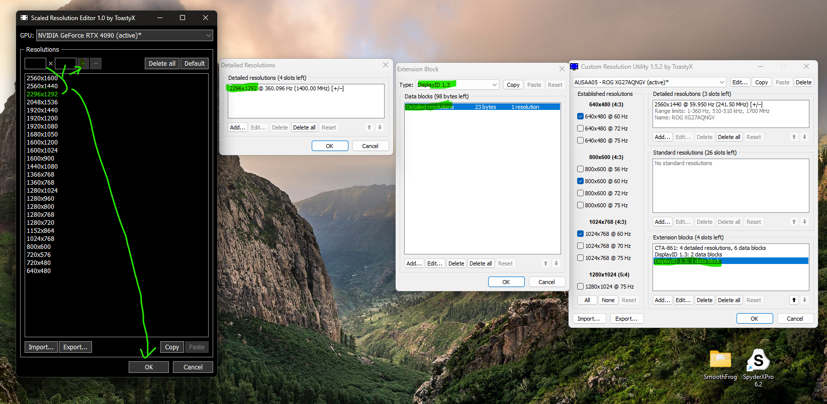

I have a RTX 3080 its not possible right to make custom resolutions and have Pulsar enabled on 360hz 1440P 8 bit? is 240hz max?
I mean by default you can run the monitor at 360 hz 8 bit color on a 3080 BUT some users have reported some black out issues due to being forced to run DSC to hit that refresh, resolution and color depth combination. Try it and see, worst case you can definitely run it at 240 hz and still have a similar experience. Pulsar doesn't work as well at higher fps than it does at lower frame rates ironically :) I normally play below 200 fps and everything looks incredibly clear compared to even my OLED monitor next to me.
Standard the monitor runs great on my 3080 8 bit or 10 bit 360hz with Pulsar only problem I have is that there is no custom res option. Is there a way to get the custom resolution available with Pulsar on 360hz 1440p?

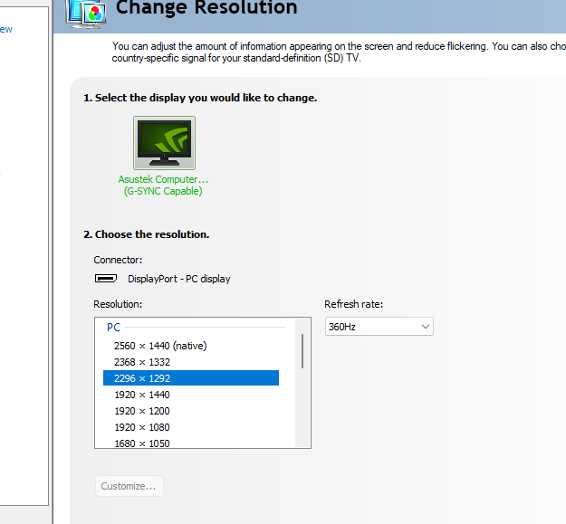

Yes you can make a cru custom resolution and use sre also, I used both, and pulsar still works , I had to turn off scaling in the osd , image, aspect control, scaling off

Tnx so Pulsar only works with custom resolutions on 240hz? I am confused cause msifanboy says he can use cru to make a 360hz custom res with 360 Hz just above this message

Tnx!!! so Pulsar works with custom resolutions on 360z? That's good news!! I am a bit confused though cause mawi says he can only make a 240hz custom res just above this message.

yes i am running 24.1 inch mode, pulsar works, scroll back to my former posts a few pages back
