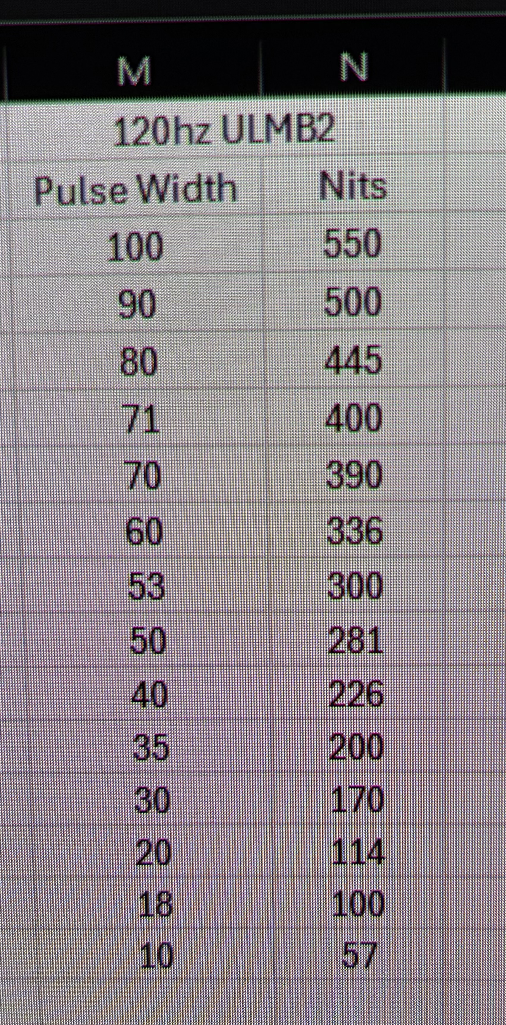

The 120hz mode has stunning clarity, very low to non existent crosstalk across the whole screen (let the monitor warm up fully). No perceivable flicker.
3840 Pixels Per Sec looks clear to me on the UFO Ghosting test but very hard to take a picture of at that speed.
A great mode for single player, controller games!
Brightness figures pretty much match up with the 60hz mode but the clarity is better at more pulse widths.

brownvim wrote: ↑
02 Jul 2026, 07:01
--snip--
Thank you for providing the brightness value at each PW setting!
