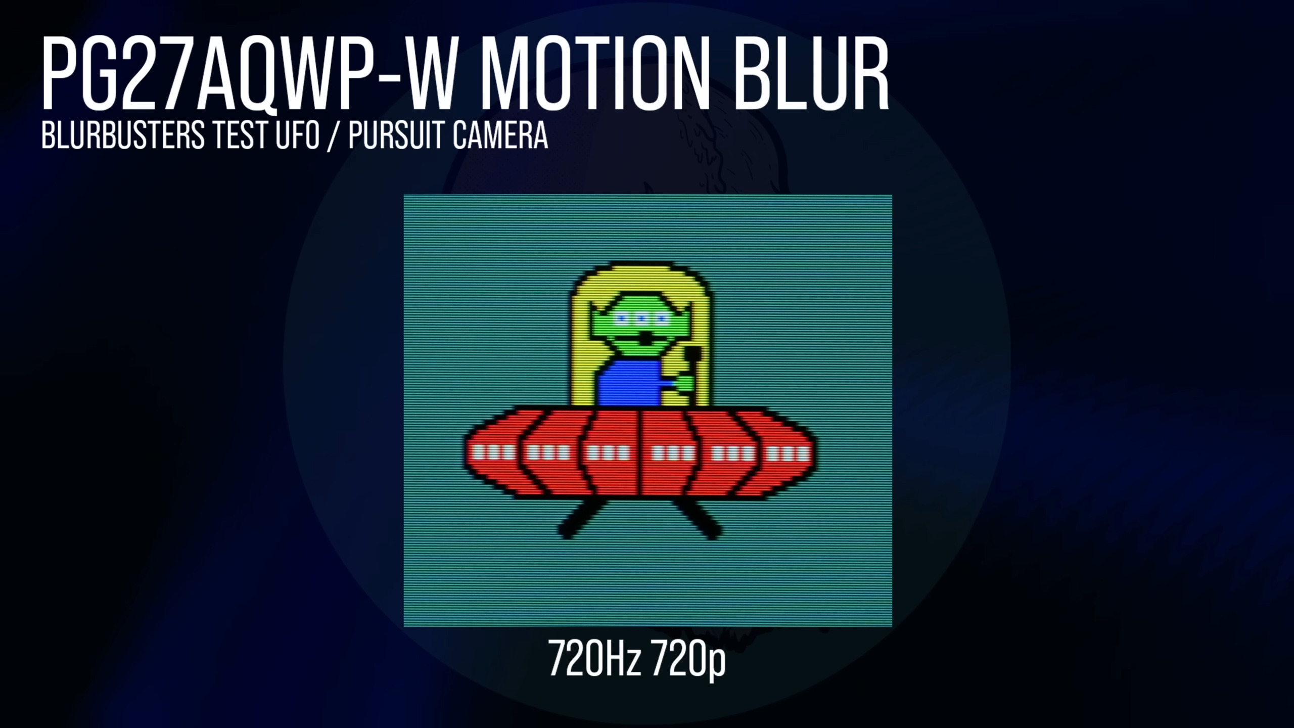

BadSeed Tech - 720Hz fps at 1ppf speed = 1px motion blur.jpg (443.68 KiB) Viewed 19148 times

Keep in mind 720 Hz OLED outperforms 1000 Hz LCD by a significant amount in the motion blur tests, even at 1920 pixels/sec.
I now recommend 1920 pixels/sec going forward for 500 Hz monitors. I may make it the new default speed in TestUFO Ghosting.

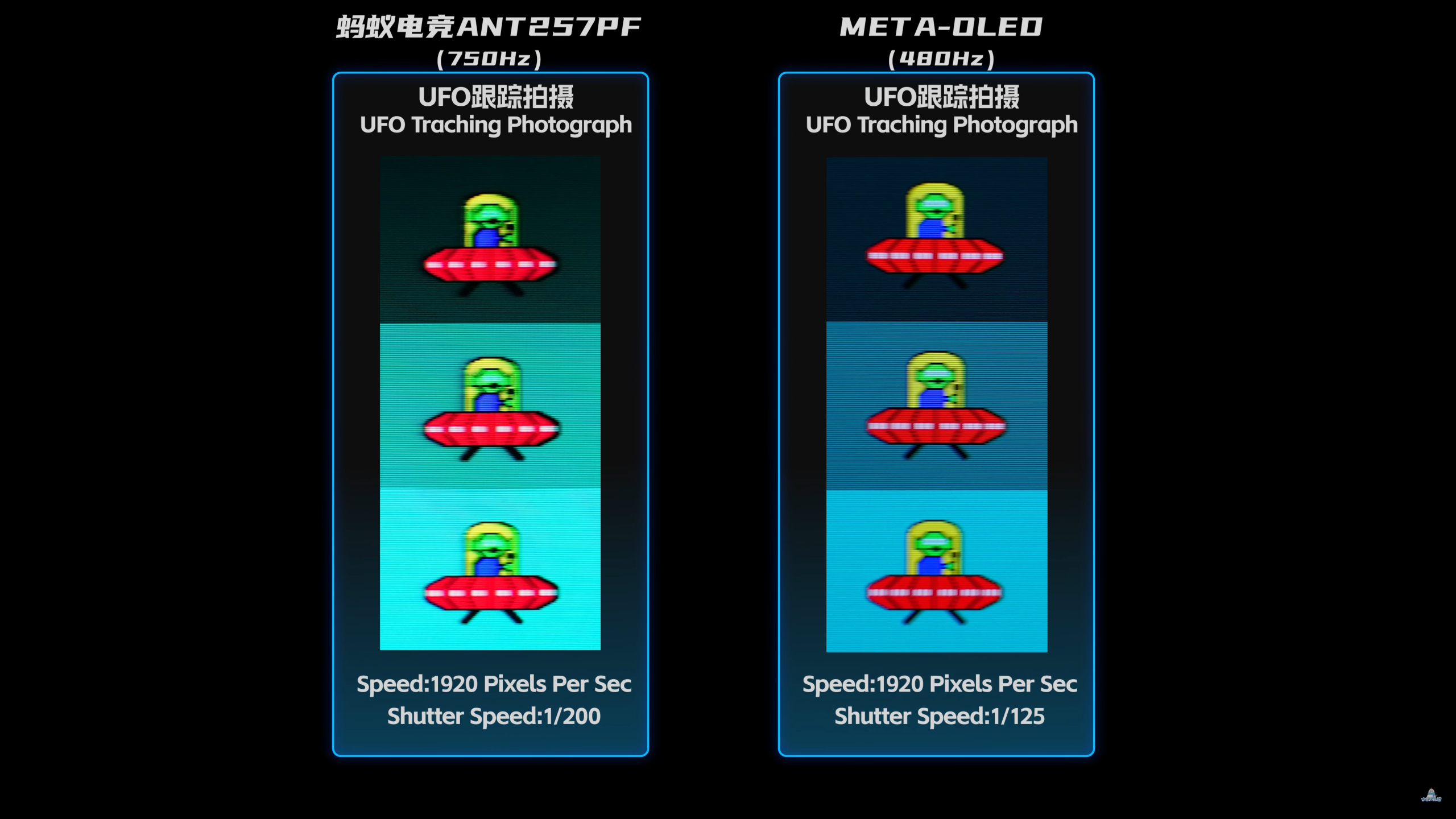

True for eye tracking tests! We already have a similar situation with 750Hz TN vs 480Hz OLED. Here is a nice example:
750Hz TN vs 480Hz OLED at ~2000pps tracking - Little Snowman Brothers.png (1.19 MiB) Viewed 18990 times
source: https://youtu.be/n3YYKqQboGM?si=9UUuonDV3ZLzMRl-&t=84
Sooner or later, default speed will need to be increased. This will make MPRT/GtG differences more noticeable and help minimize deviations in target speed. Currently, 720–600 Hz displays pan at 720–1200 pps when using the 960 pps preset, which is a notable 25% deviation. Increasing the speeds will reduce these errors.

Any idea why the maker didnt use higher shutterspeeds like 960/1500 or 1920 /1? Shouldn't even phone cameras not darken the image too much?
See the tool tips at https://testufo.com/ghosting -- Long exposure speeds for pursuit cameras are intentional to emulate human eye, to get WYSIWYG motion blur photography. It's a scientifically peer reviewed inventon. The standard is to configure the shutter to 4x refresh cycle to match the human-perceived display motion blur.
Conference paper at blurbusters.com/motion-tests/pursuit-camera-paper/
Tracking camera = Tracking eyeball.
(Moving camera as an analog of a moving eyeball).
Short shutter speeds make it inaccurate for the pursuit camera. Look at how sharp the 720Hz picture is despite a slow shutter speed on a moving camera -- that means the display is so fantastic at blur busting it even busts camera-panning blur too.
